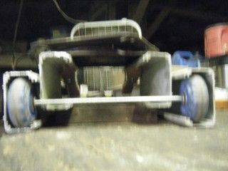

Here's a couple shots of my Rowing seat ideas. It's worked out very well.
It not only helps to get a longer stroke out of the Oars, but makes it easier to reach the front and back of the boat when your alone.
I put a 'Lazy Susan' on the carriage and a good comfy seat on the lazy Susan. Perfect for all occasions. You can say Wheeee as you whirl round n' round on the seat.
With the rolling rowing seat, you can put in that second set of Oar Lock Sockets and row from there if you have a passenger.

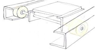

This is a drawing that might help explain my Seat job. It's all 'stuff' I pickup up after a Tornado went through here.

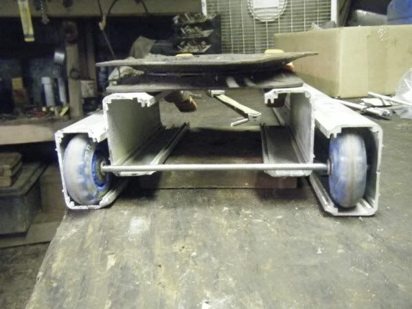

This is the end view which is still in the boat today. See the Lazy Susan up on top of the carriage?

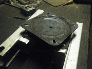

Top View of old rusty Lazy Susan from a Ditch. The rails are from a wrecked RV Awning, the wheels are from a single Roller blade, the only thing I purchased new was the two All-Threads to use for axles.
