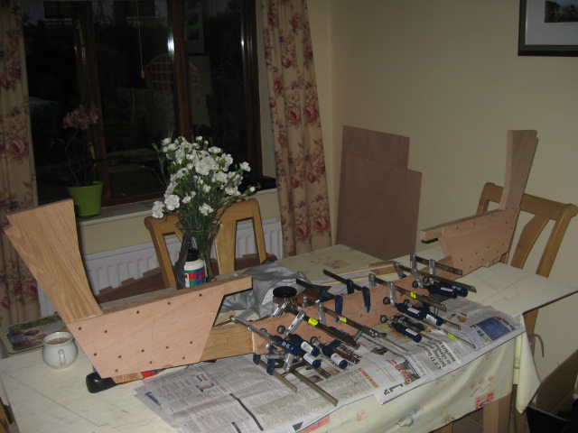

Dave... I like the vase of flowers on your workbench. That's a very nice touch. :wink:
(+1 on the pilot holes... I learned that pretty quickly... but - as Ken suggests - on my next boat, I probably won't use the bronze ring nails...)
