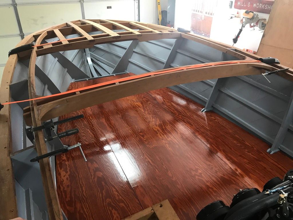

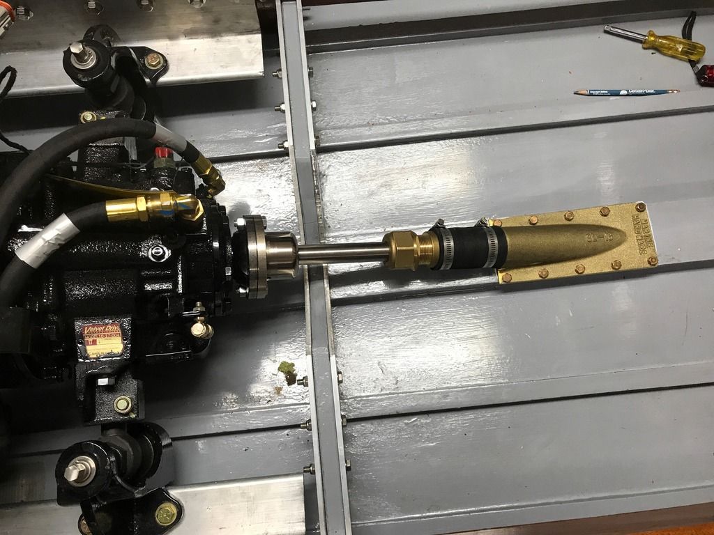

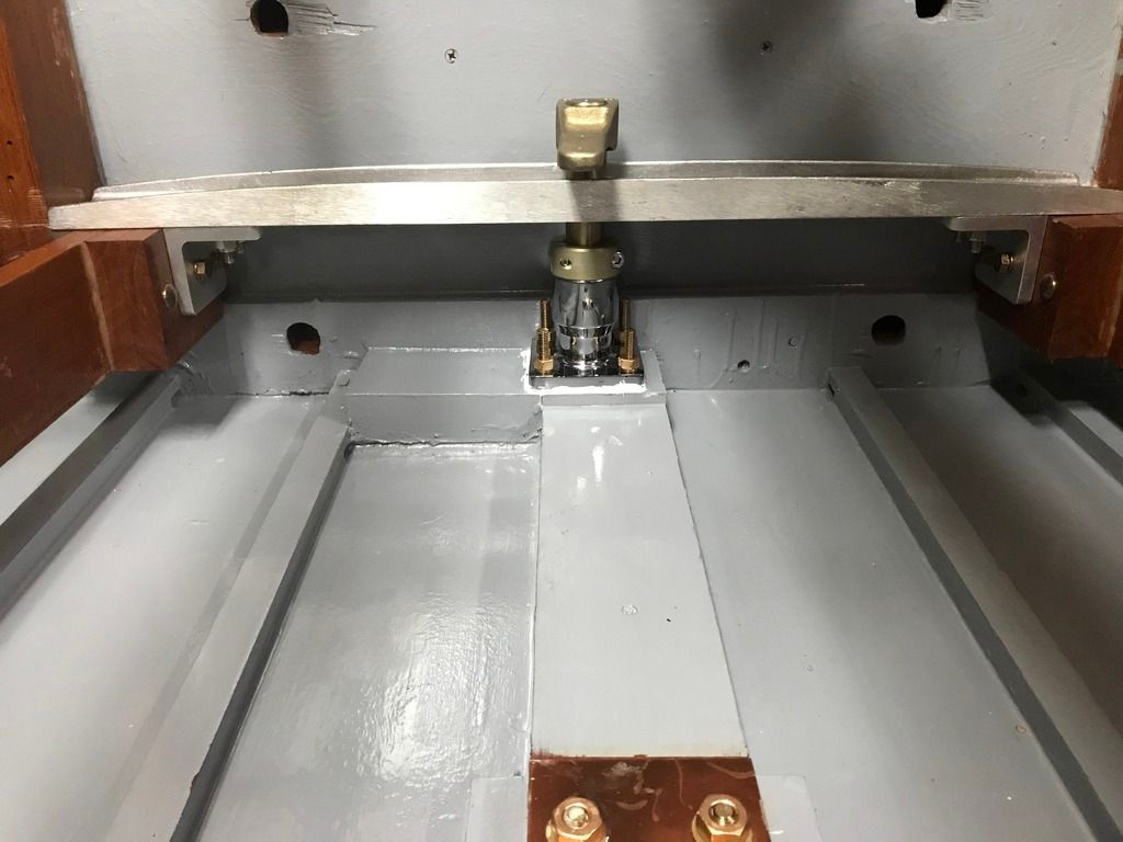

Little more progress... couldn’t flip the metal support, not enough room... got the floor boards in to see how they look, shaft log is sealed and tightened down, and have the rudder bracket all locked down. Still figuring out the raw water intake and where to put the oil filter.

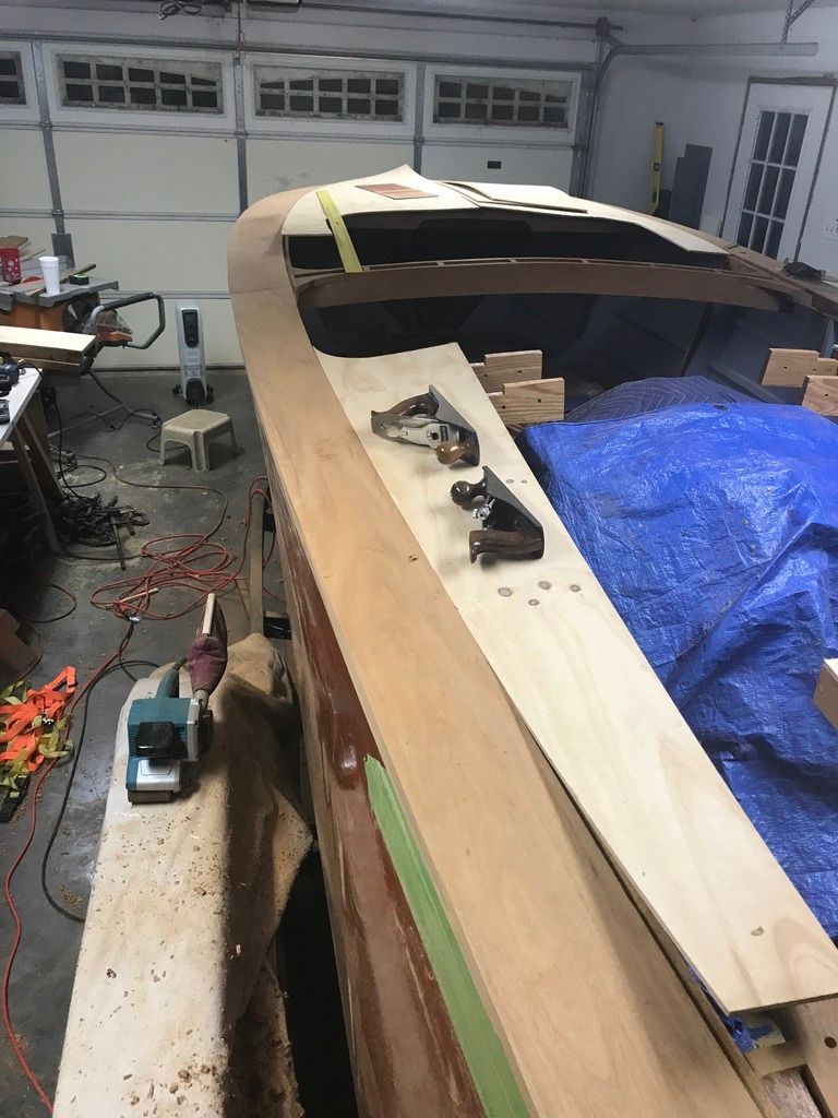

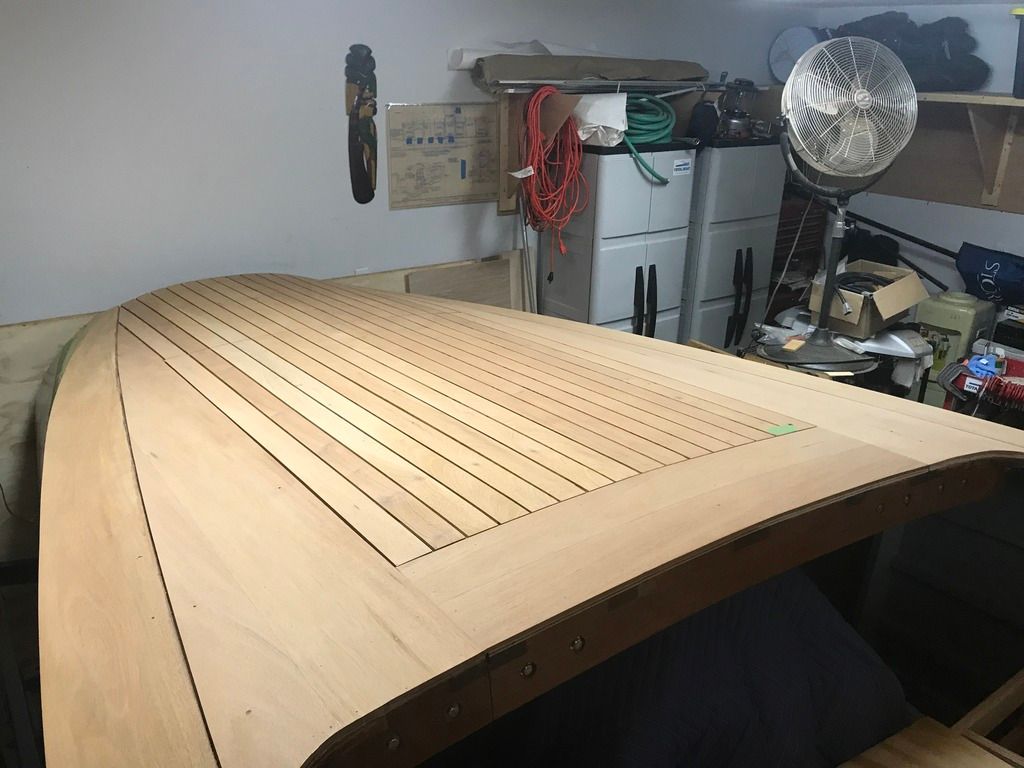

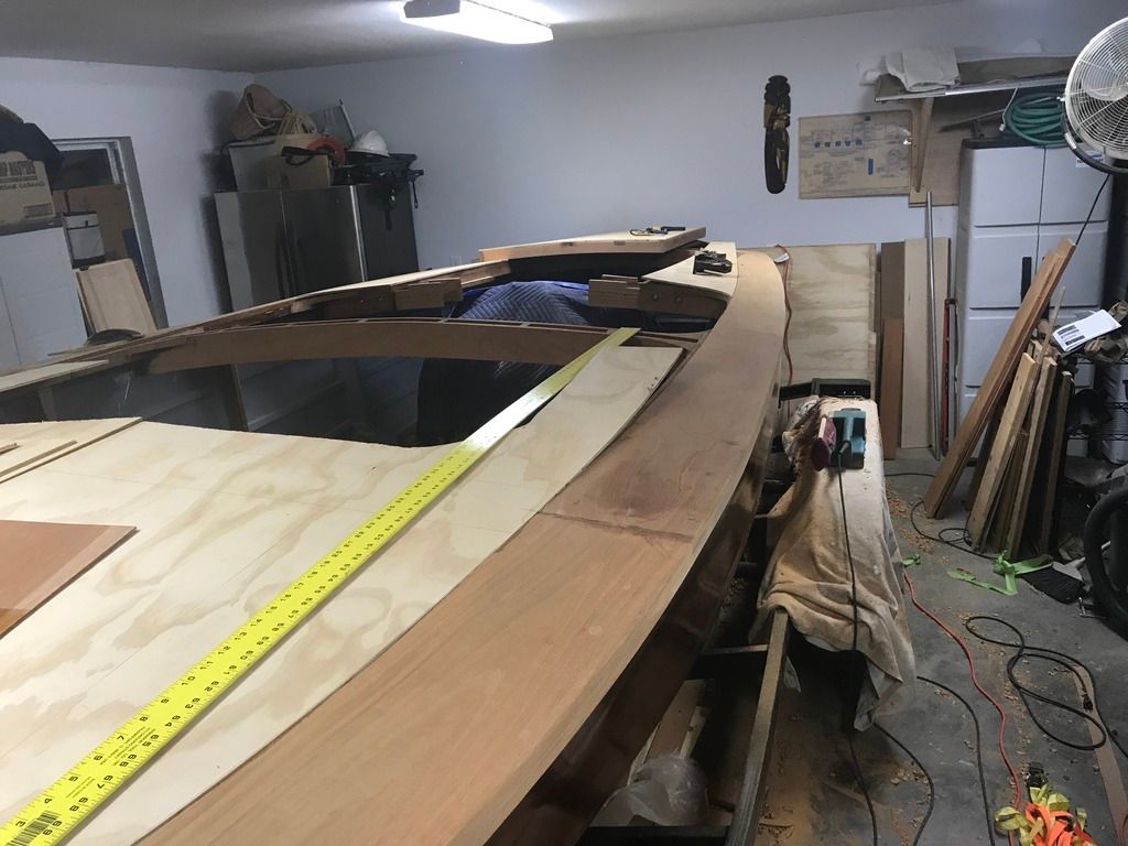

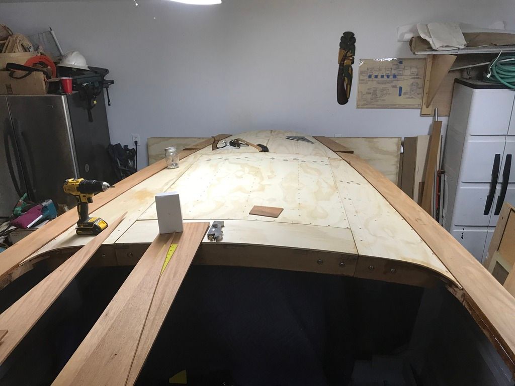

I have made some progress on the cover boards... Need to same the rear end so everything meets properly. All the sub deck is fitted and now just trying to determine planking pattern.
We have about 3 inches of snow, delaying the planning of the planking... Give me some time to finesse the cover boards.

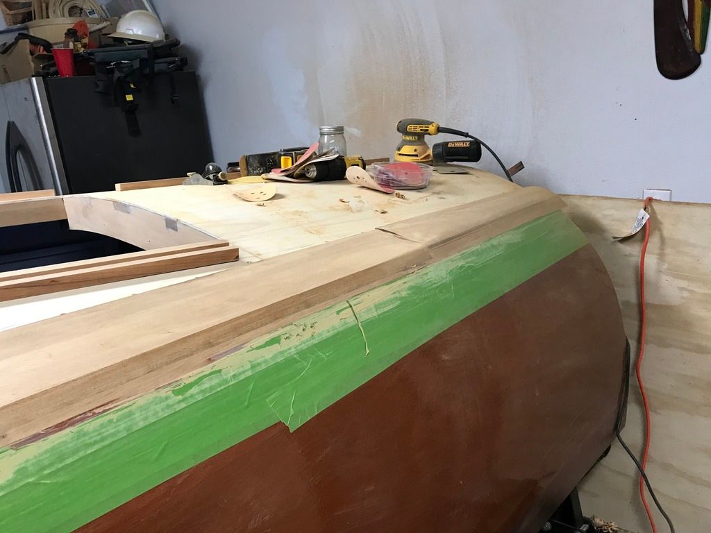

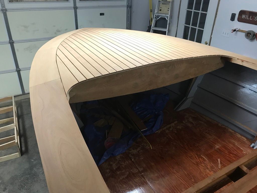

Well after the flu swept through our house and travel for work, I made a little more progress on shaping the cover boards and prepping the hatch. Slow and steady I suppose is the key.

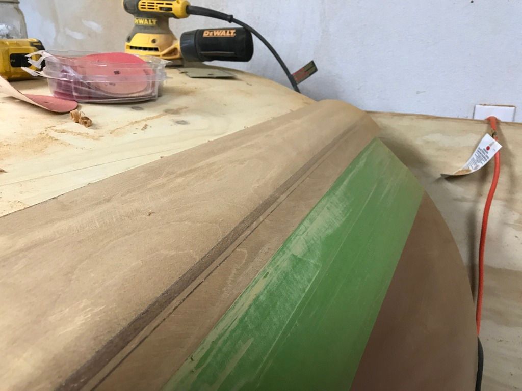

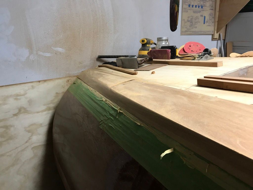

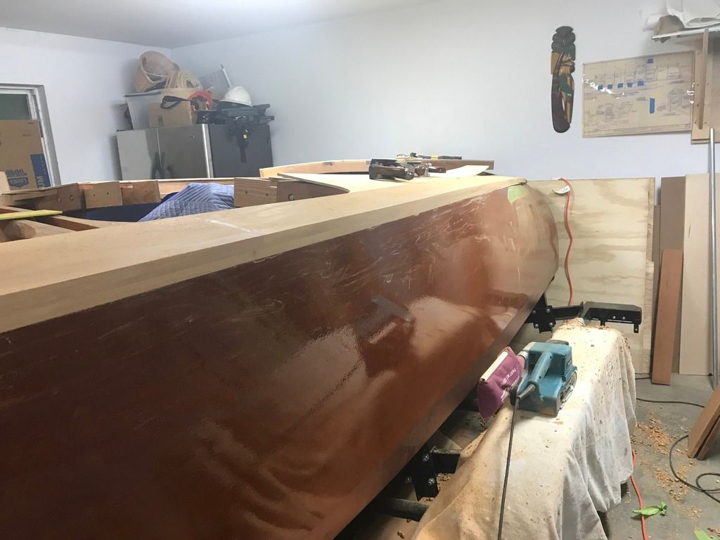

It looks, to me, like you did not fiberglass the last inch or so of the side planking near the sheer. The inch or two above the green tape? Is that right? I have been thinking about this step and worried that I might have to cut into the fiberglass where the top of the planking meets the cover board.

Really interested in how you blend the covering boards.
Mine stand proud as a seperate element but I'm thinking to blend them in the stern.
I'll send pictures... Mine are constructed slightly differently. I deck edge to edge with plywood then am applying a 3/4 inch covering board.

Mick sorry for the late reply.. I do not fiberglass the sides. I fiberglassed up to about two inches above the waterline. Just stain, sealer, and varnish to the top sides.
The coverboards, I followed Mr Jim, used a filler piece then laminated a solid 4/4 on to of that. Then lots of sanding at the transom. Just go with the hand sanding went you start to get close to the joint of the deck and sides

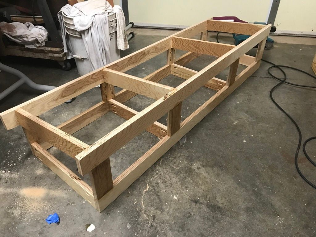

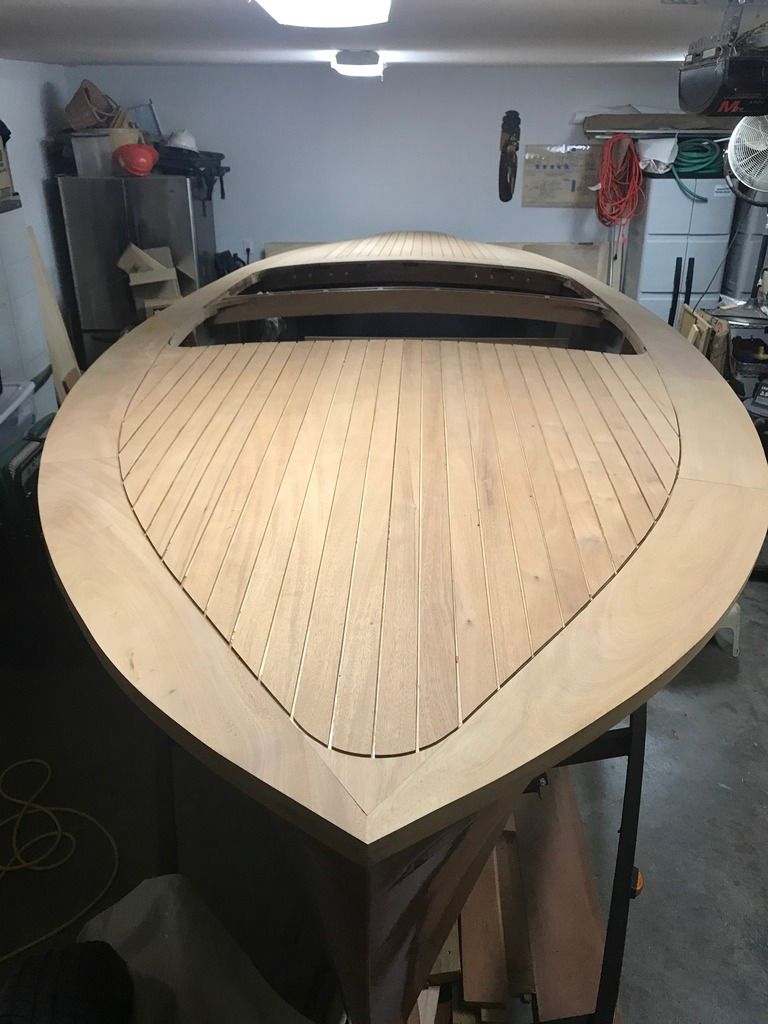

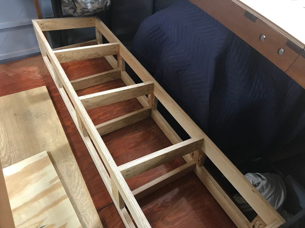

Been busy with work this spring but I did get the deck planked and getting ready to do the final deck sanding. I have also been working on the seat foundations.
