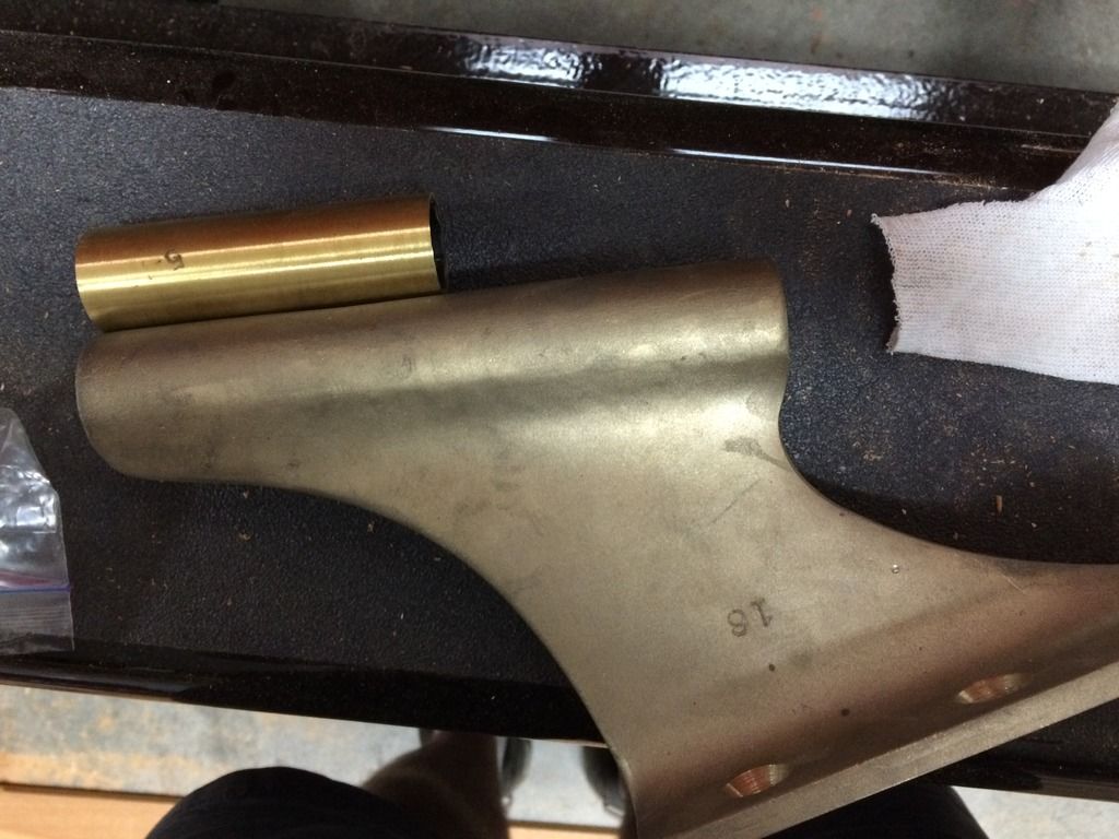

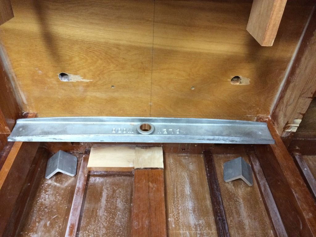

I've got a few questions for you all out there.... I have been sidetracked for a while as sometimes in life that happens....
1. How do I attach this thing. HA HA... Is it easily drilled? I was thinking getting some small lags, bolts, to attach the brackets to the cross bar and then attach the brackets to the motor stringers. Can you all point me to a picture that may have been posted already?
2. I have one blackfish bearing for the strut. Do I need two of them to fill the whole length of the strut? Also, I think I read in one of the threads somewhere, probably's Roberts's thread about using a threaded rod, nut and larger washer to push the bearing into the strut. Does that sound right?
I am prepping the inside of the hull right now for bilge paint and I have been cutting the additional beams for the seating areas. I've got a lot of catching up to do with JimBob, which his boat is looking awesome!!! All of you have been making some great progress...... I got a lot of reading to do on the threads as well.
Thanks in advance for all the advice!!!!

it is easily drilled, I Mounted the right angle brackets on the motor stringers then clamped the alloy rudder support and right angle brackets together then drilled through I cut a 5/16th unc thread in brackets and used domed cap screws, but bolt and nut is fine
cut your strut bearing in half and put 1/2 in each end of the strut using threaded rod
download/file.php?id=15738&mode=view

I used two three inch bearings and put one in each end.
I used 3/8 " threaded rod on the first bearing and couldn't get it all the way in .
On the second one, I put it in the freezer first, and used 1/2 threaded rod with lubricated threads and it went easy. Was also able to finish the first pull with the larger rod.
Doug
Posts: 6404
Re: Barrelback 20'
Post by Roberta » Tue Aug 02, 2016 4:34 am
I also used AL angle brackets bolted to the stringers and then to the bracket like Jenko did.
On my strut I used one 4" bearing and cut it in half per Glen L instructions. Then installed the 2" pieces in each end with a 1/2" threaded rod, washers, and nuts. Like Doug recommended, freezing the bearings will shrink them a bit and help draw them in.

Post by alycat » Tue Aug 02, 2016 11:05 am
Thank you all!!!! I appreciate the feedback!! The picture explains it well..... Thanks!!

Hi Will,
This is what I did with the rudder "thing". It is made of aluminum so it is easy to drill. I added blocking to the insides of the motor stringers so they are flush with the top of the motor stringers. I drilled additional holes in the "thing" and then attached it with bronze lag bolts. I didn't use the angle mounts that they provided.
Jim Neeley

I used these Cutlass Bearings.
http://www.skidim.com/XPC-STRUT-BEARING ... o/OJ2025B/
One in front and one in rear. They are holding up great.
