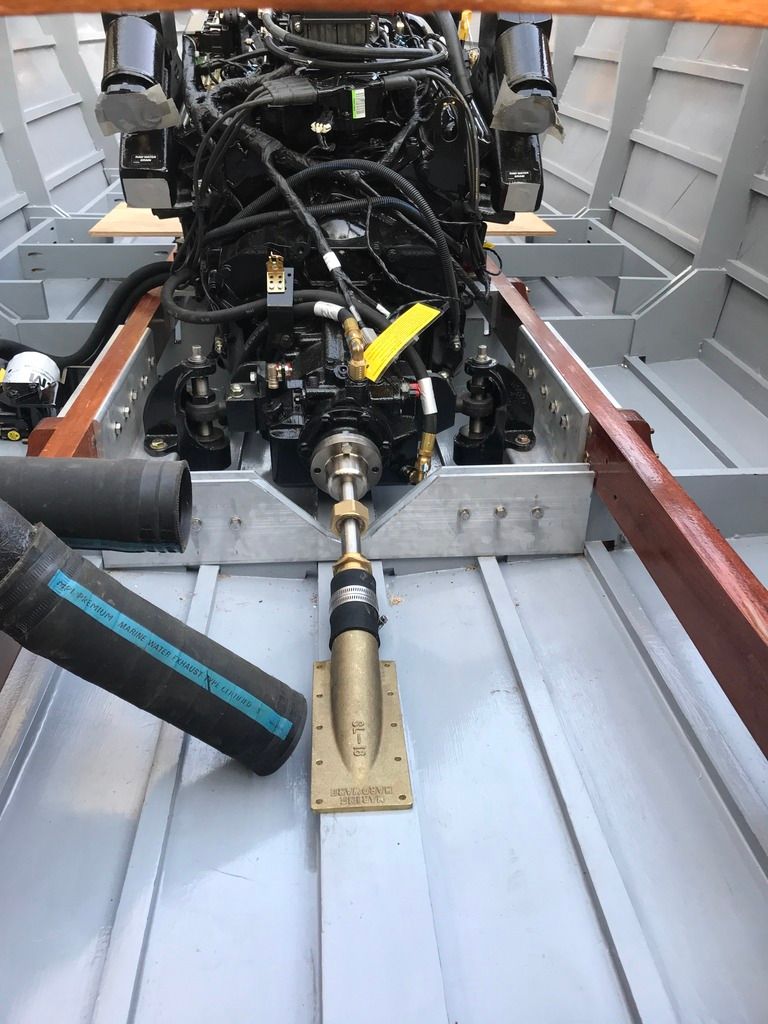

Thanks guys... tho gut I would reinforce this frame since I took so much out of it. Trying to relocate the oil filter on the engine and also fixing to get the rudder shaft thing in :wink: Also stained the floorboard, so either I can put somethings my loosely over them or let the wood show..options I suppose...

Post by Ozzieboat » Sat Nov 11, 2017 9:05 pm
If there is clearance for the half coupling and shaft, to get the most benefit from the reinforcement turn the rear plate upside down.

Post by alycat » Wed Nov 15, 2017 4:15 pm

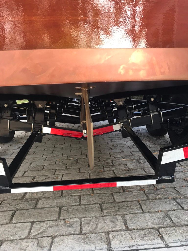

I’ll try that, just got the drive shaft in so I’ll see if I can turn it over. Got some other fittings today for the raw water intake and picked up some mufflers that were taken off another inboard at a great price.
Got to seal up the shaft log and figure out where to put the oil filter, finish supports for the rudder etc.
I offset the rudder to the right due to haveing a standard rotation (CCW) , I have a 71C transmission which should also turn the prop (CCW) I hope. My mechanic said that the transmission sometimes is setup to turn the prop CW. I checked the model number with a velvet drive install manual and it says it should be a left hand prop... so I think I am good. Any way to tell without starting then engine?
I know this has come up many times on the forum. Don’t want to redo the rudder hole... Ha ha
