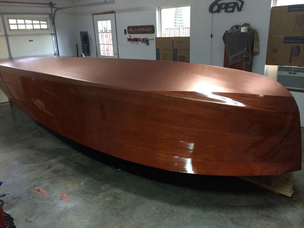

Stain Question.....
I put on the stain on one side and the back. The back looks good, but the side has some variation, I assume due to my poor wiping ability with varying hand pressure. I somewhat freaked out due to not taking into account how fast it started to dry before I started wiping, so I had to add some 333 thinner to get it to wipe. It is hot here in Louisiana. :shock:
My question is, can I go back and apply more stain and wipe again to even everything out, or is there another process.
I still have the other side to do which, I will apply in smaller sections to keep the drying under control.
Thanks for all the advice, I want to get this part right. The pictures really don't show the variations but I definitely can see them.

Wipe it with something that will not lift the stain - not sure what you are using - but mineral spirits, alcohol, etc.. looking at it wet will show you what the end result will be. When it is dry - it can look really bad...
If you used the Interlux stains - it has to be reduced to be used - and even then requires a lot of buffing to get the grain filled, etc. You can go back and add more and buff again if you don't like the color.

Thanks, I have some denatured alcohol I can wipe with.
I am using the interlux stain. I thinned to a thick house paint mixture and rolled it on, let sit till it got dull then started wiping against the grain. I just looks like I got some streaking due to different pressure in my wiping technique.
Thanks again for the advice !!

I thinned down to heavy cream.
You need to use a coarse cloth and really buff it off. More like waxing a car than traditional staining
I used cloth to rub it on too. a roller may be a bit to heavy. But you have been there already.

Posted: Fri Mar 18, 2016 9:10 am
by alycat
Finally made the flip after a year of life's turmoil's... Now onto the internals and topsides

Absolutely stunning Will! Looks good on the trailer, though I think you may have to lower her to access deck and interior work.
Congratulations.
