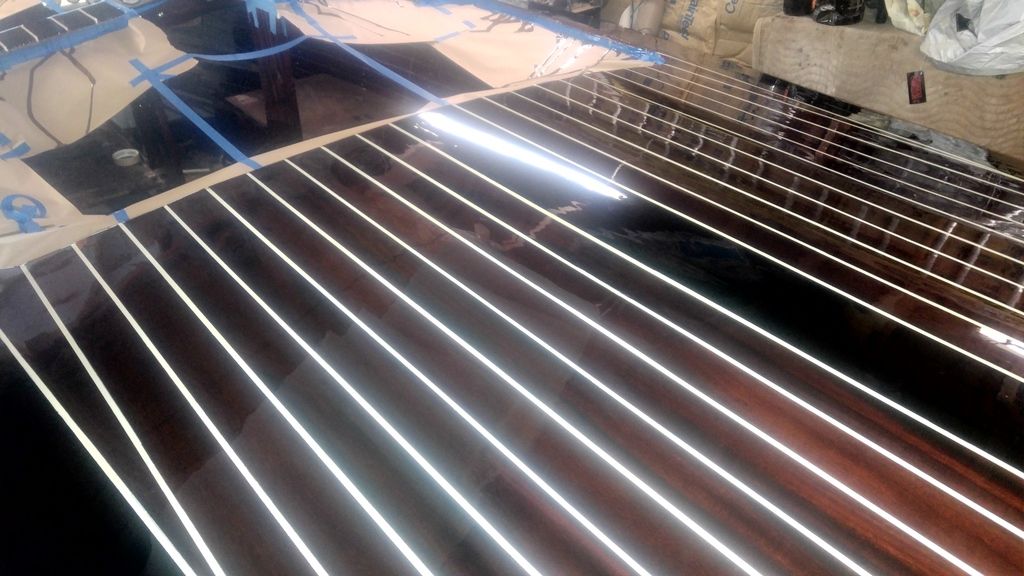

Here is coat number 5 of the Silver Tip.
My goal is to have it smooth enough so you don't feel the caulk lines. It's pretty much there. Only a few spots left. I'll do one more coat tonight then sand it down again this weekend. Perhaps a couple more coats next week then sand it once more before it goes off to the body shop for automotive clear.
The white is reflection, not flaws in the epoxy (I can point out plenty of flaws though. Ha)

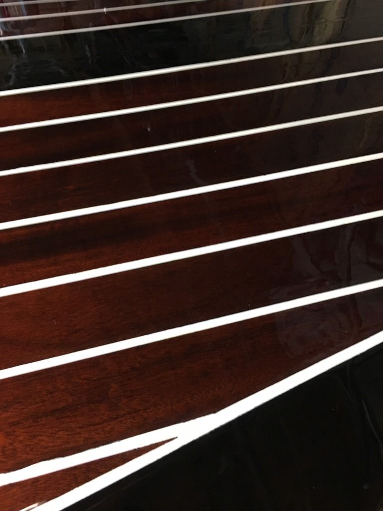

Last coat of Silver Tip!
I have been applying 2-3 coats, during the week, then sanding on the weekend and repaeting.
I think I'm done. If this Silver Tip had any sort of UV protection I'd call it completely done. But no....it doesn't protect from UV rays so I'll be sanding once again this weekend.
Seeing these pictures makes me sick that I have to take sandpaper to it. It looks pretty good (and these are cheap cell phone pics).
