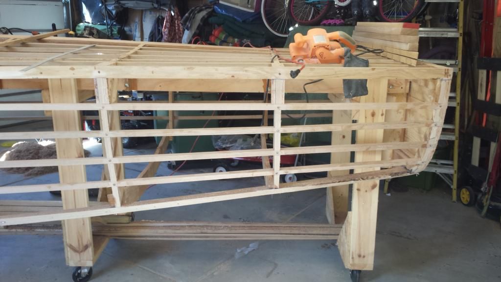

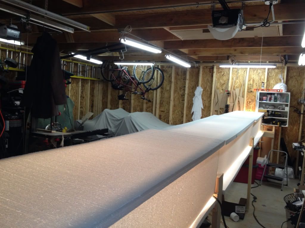

Last winter was my first winter with trying to use epoxy. I built the heat tent out of Styrofoam panels built around the stringers. It worked great.
I didn't accomplish much last summer because I was always scheduled for other stuff. Not complaining...just enjoying life.
This winter I took a month off of the boat and tried insulating the garage. It's still freezing out there and I haven't been able to glue anything. So, I have been sanding and fairing.
I have built up the transom framing, but again, I can't glue it in place when it's 5 degrees.

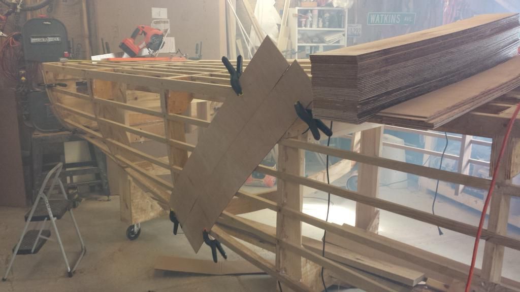

Waiting on the weather, I have pre-cut up 5 of my sheets of plywood into 6" wide strips. That's 5 sheets of plywood stacked in one stack there. I clamped two strips to the side just to see what it looked like. (I've seen so many other photos like this and had to do it myself.) I also have the Omer brad gun and Raptor brads ready to go.

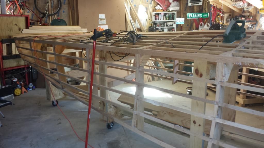

Just a cool shot showing the taper of the hull.

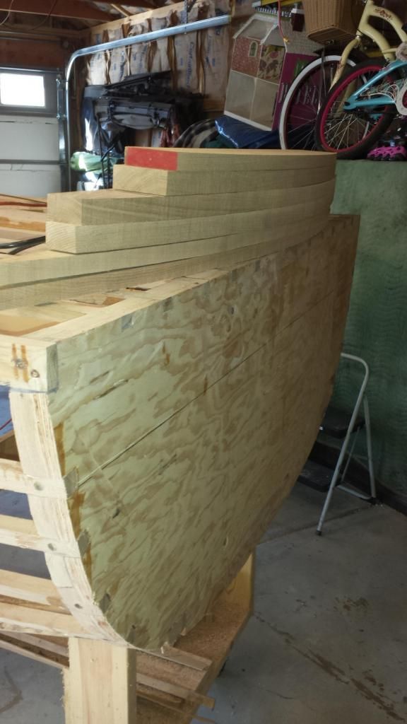

Finished the transom framing
Then closed it off with some 1/4" marine plywood. No need for strips as its only a single curve.
