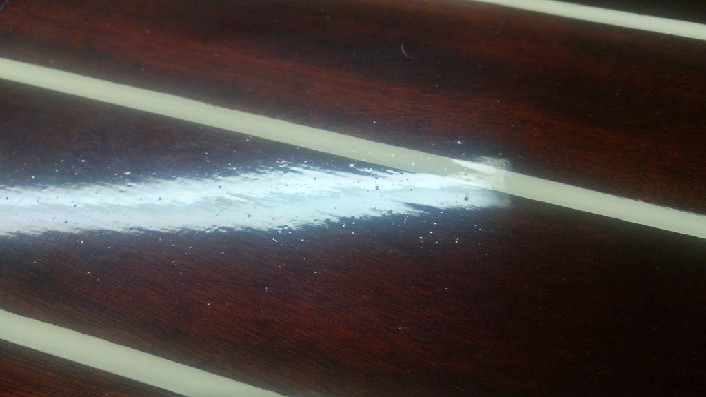

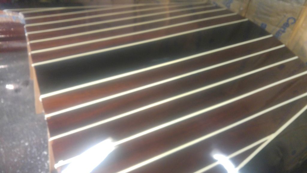

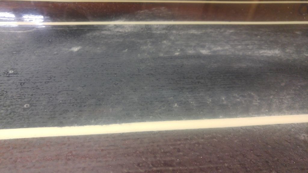

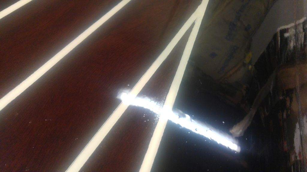

So I took the next step. I decided I wanted to sand and buff the clear. From a distance it looked great. Like this

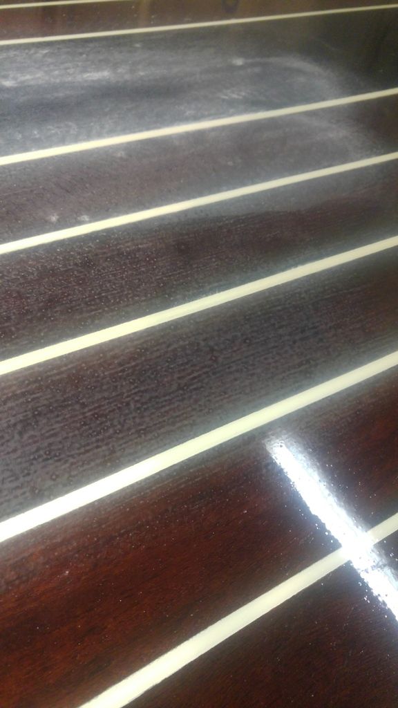

Up close, there was a ton of dust. I read the reviews on this clear and people kept complaining about tons of bubbles. If you tip it right, there are no bubbles. I think people were seeing dust. It dried like this

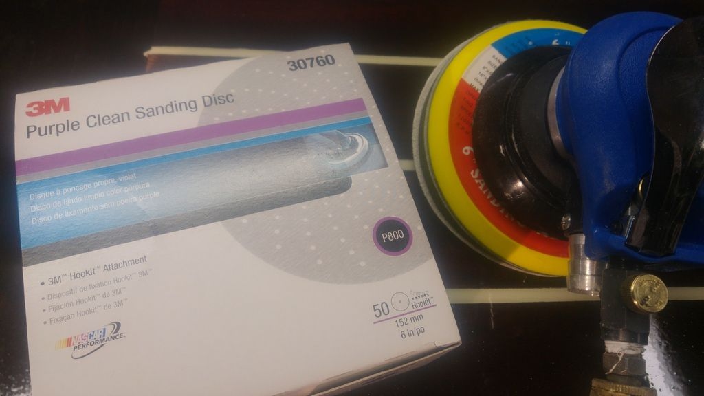

I'd like to lay out the steps I took to fix it. First let me say I am not an expert here. I'm sure some would think I did it wrong or have other ways to do it. I'm not claiming the is correct. I'm only listing the steps I did after getting help from Skip (with the awesome Monaco) and research on YouTube. Again, this may be wrong but it worked for me and hopefully it can help others in the future.
I first sanded it down with 3M 800 grit purple sanding disks. It was done dry. Skip warned me I would go through a ton of discs. For this first step getting the dust and brush marks (from tipping) it was a long process and I went through about 30 discs on the deck. Once they stop cutting, they flat stop. It's amazing how suddenly they work, then just stop.
Here I have started sanding and you can see the brush marks and sand specs. More sanding required.

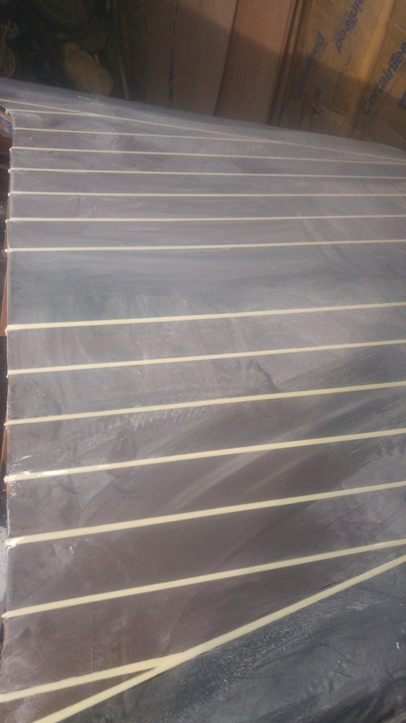

Completely sanded
Then you need to wipe it down before moving on. They say to get the course residue off the surface or the next step of finer paper would just swirl it around

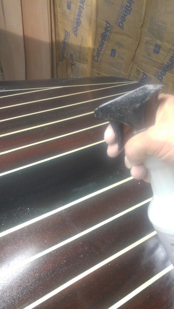

Next was 3m purple 1200 grit. It did this wet. Used a spray bottle with a cap of dishwasher soap in it.
Again, clean it up before the next step (don't have pic)

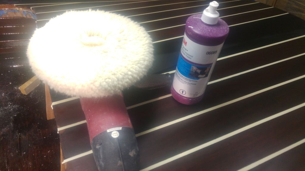

Next, I used a wool pad (thanks again skip) and 3m compound.
This takes a lot longer than I expected. I was thinking the gloss would just reappear instantly. It takes some work. Lots of compound and always moving to prevent burning. As I said before, I'm no expert. It was my first time attempting this. Others may be able to get the shine right away. I couldn't but it eventually came in. Sorry, bad picture with residue slung all over the surface.

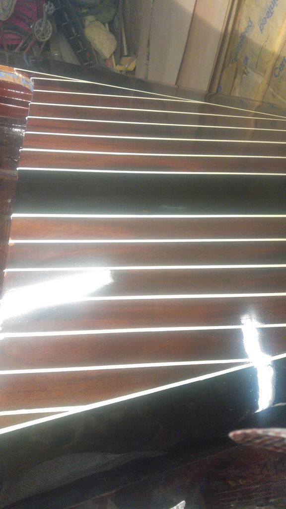

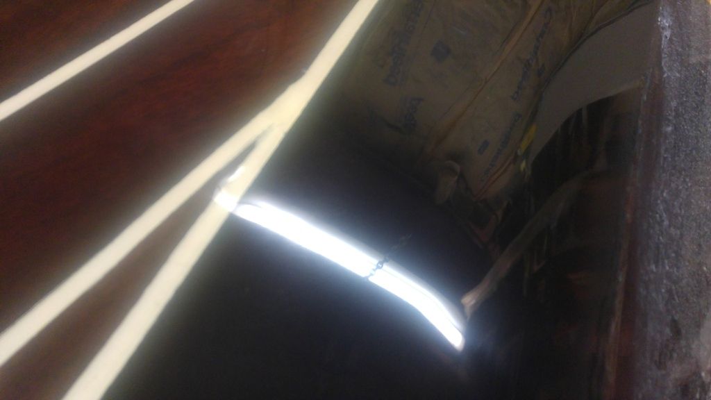

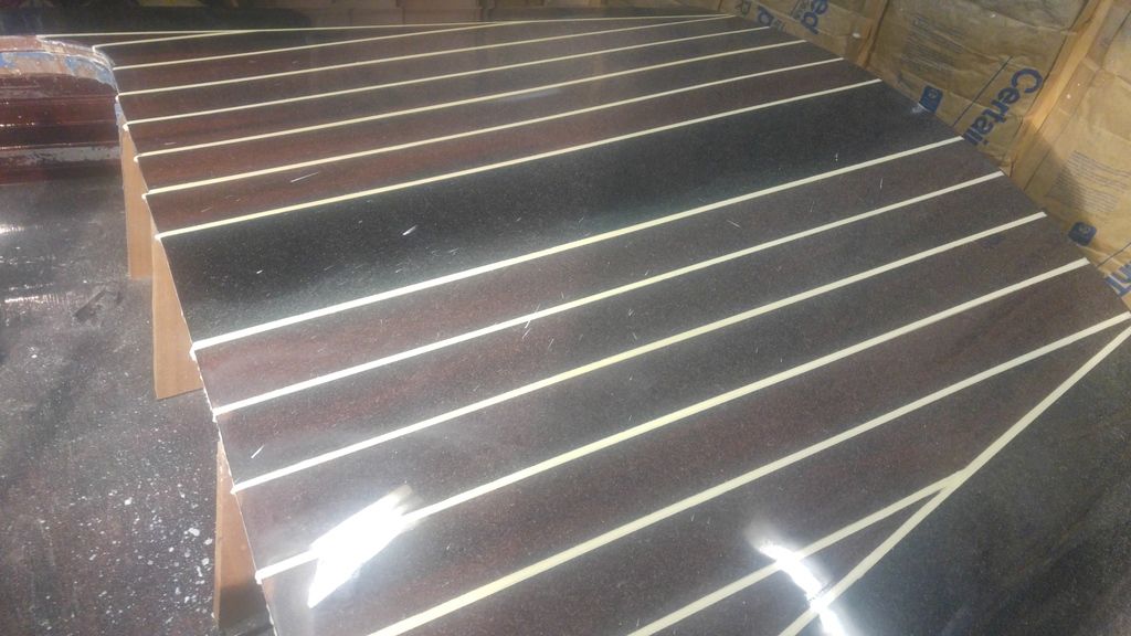

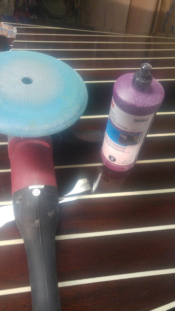

Finally I used a polishing compound and a foam pad. It took all the swirl marks out left by the wool pad.
Here are the same pics where the dust was showing. Much better! Note the line through the reflection of the light fixture is a chain from my engine hoist. Pretty good reflection.
Again, I'm not saying this is the way. It's what I used. It's still not perfect, but much better. I was quoted $5,000 to clear the boat at a body shop. I spent about $400 on Perfection Plus varnish and another $200 on sandpaper and compound.
I still see some minute sand scratches in certain light. Maybe I'll get better with this and redo some areas.....or maybe I'll call it good enough and actually be done with sanding on this project.
