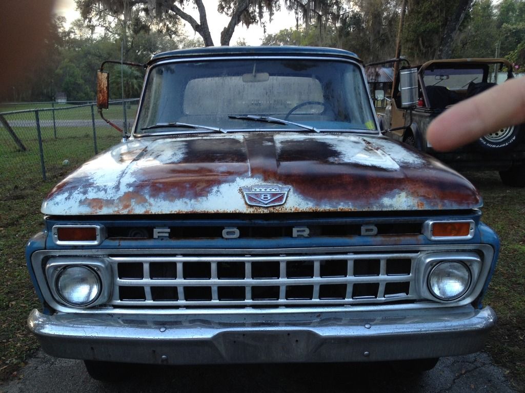

specialk wrote:Ok I am posting this Pic.. by special request...for Travis24....shop truck 66 ford and my wood shop...
Nice '66 !
Here's my '65 F250, 352v8, 3spd, 4:10, 99k for $250,00. Not finished yet but getting there. It was sitting under a Oak tree for 15yrs. New everything almost. It was rough.
