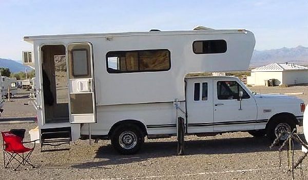

What's an Everglade look like. Post a photo.
:? I couldn't sign into the Customer's photos.

thudpucker wrote:What's an Everglade look like. Post a photo.
I have not started building my camper yet but here is a picture of the one that inspired me to buy the Everglade plans
The whole camper was very well done and I would recommend viewing the rest of his pic's located at
http://glen-l.com/campers/rv-picboard/rvpic16a.html
