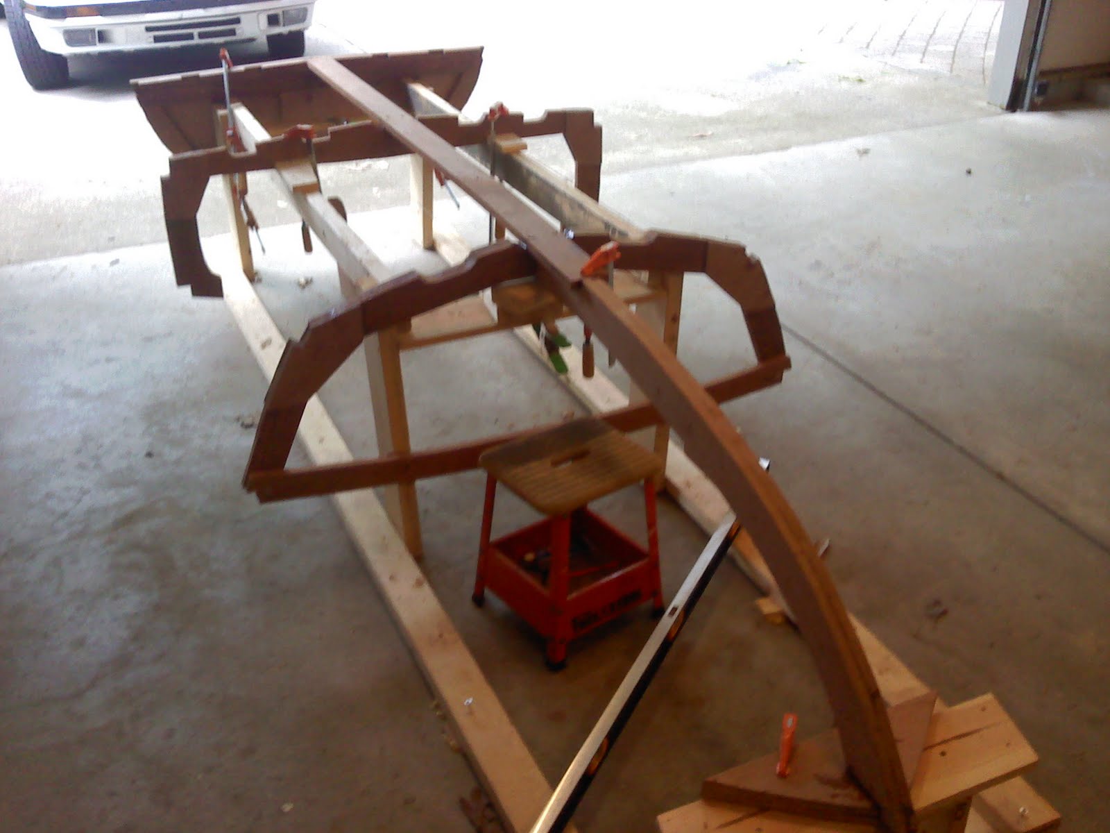

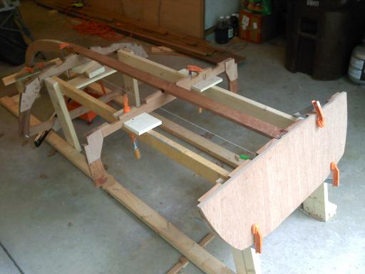

I decided to start posting some progress of my Squirt build as it seems to start looking like a boat now. I just got done with my junior year at WMU and am still in the process of finding a job/internship so I have had a lot of time to work on the build; definitely not complaining! I had originally started this build in the middle of July last summer but was only able to get the frames cut out before I had to move back to school. Luckily I had quite a few Squirt and other blogs bookmarked and was able to control the "itch" for the winter.
I haven't built anything before, let alone worked with wood, so I was pretty nervous when I started but was reassured when my cuts matched those online. The only problem that I have had so far was cutting the 12 degree angle in the transom. I used a table saw but the fence ended up moving and I had cut a 0.5'' off one side and 1.5'' off the other. This ended up being good though because I didn't realize there was a slight "V" in the transom. I'm still going to finish it though an make a wall mount out of it.
Anyway, I hope to begin planking this weekend, though my learning curve is making everything take a little longer. Today I'll be putting on the battens and figuring out how I'm going to do the sheer; a family friend made a steam box that he used on a restoration project so I might use that. I'll be posting all of my progress on my Blog and just post any major updates here. The blogs have been a huge help for me so I decided I should return the favor to any future Squirt builders. Thanks again for everyone's help and I'll keep my progress posted.
I have been using my phone for pictures so the quality isn't great for these but I'll be using a regular camera in the future.
Frames, Transom, Breast-hook, and Stem Attached
Keel Attached
Keel View #2
Building the Squirt

Nice work! You look like you know what you're doing.
One pointer - Make sure you can get to where you mount the frames to the building form once you get the plywood on. (I tell you this from experience.) What seems like a good mounting point disappears when the hull gets in the way.
Keep us posted,
KB
I remember hearing this somewhere else as well, maybe on your blog? I went and checked tonight and sure enough decided to make some adjustments!
