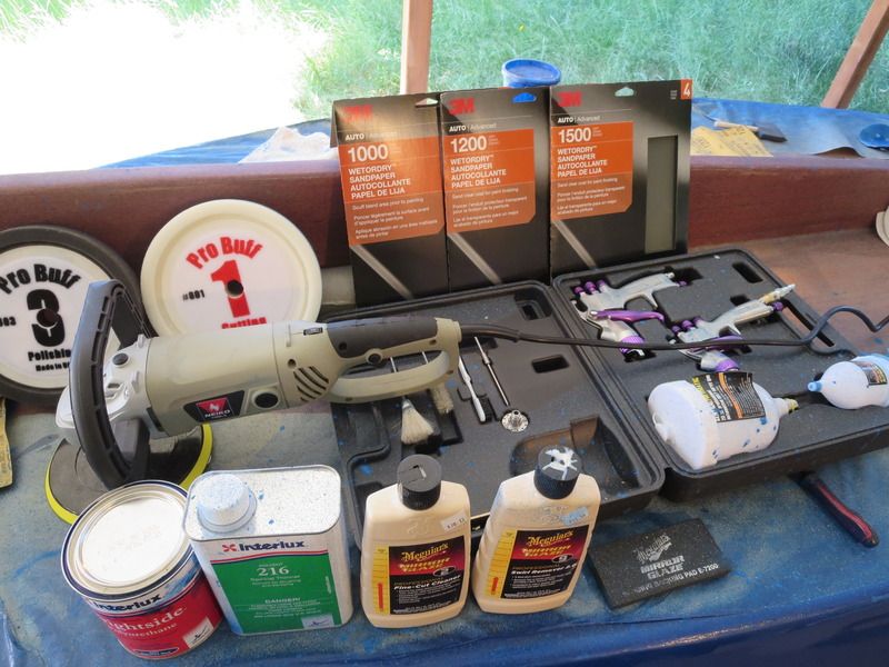

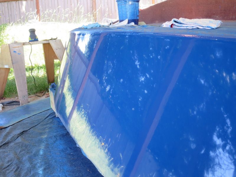

If you want a mirror glaze finish, you can try what I did. But you'll need to buy a few specialized tools. Harbor Freight can come to your rescue here. You'll need a HVLP spray kit and a good polisher. (I used Interlux Brightiside paint.) Use the recommended thinner (I think I used 216). I had to go to a 1:1 paint/thinner ratio, on the recommendation from the manager at the local auto paint store. I know that sounds extreme, but the resulting orange peel texture is very fine, and easily knocked down with wet sanding prior to polish.
In a nutshell, here are the steps I used:
In every sanding/polishing step be careful not to cut through to the primer.
Several coats of very thinned paint with light sanding between coats (210 grit, using RO sander).
Final 210 grit sanding, very light.
Wet sand by hand, 1000 grit paper wrapped around a small sanding pad, back and forth strokes, not circular strokes.
Wet sand by hand, 1200 grit paper wrapped around a small sanding pad, back and forth strokes, not circular strokes.
Wet sand by hand, 1500 grit paper wrapped around a small sanding pad, back and forth strokes, not circular strokes.
Polish with Maguire's #2 cutting compound, #1 pad.
Polish with Maguire's #9 polishing compound, #3 pad.
This gave me a very nice mirror coat finish, without having to apply a clear coat over the top.
These are the tools and supplies I used, plus a compressor, not shown.
I hope you find this info useful. Good luck and nice job so far.
