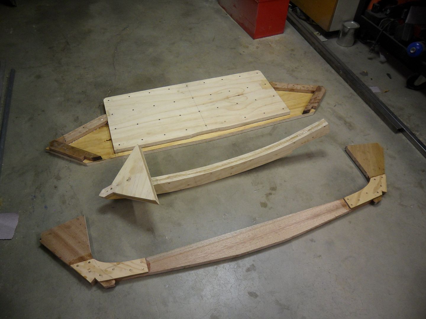

It hasn't stopped me completely though, as I still had some Mahogany left over from the Spartan build, almost enough for all the frame work. I had some .750" plywood from another project, so I made the stem and transom with it. Nothing is glued together yet, but I'll glue up the transom and stem pieces this weekend. I also have lot's of spare .125" Okume plywood that I'm thinking of doubling, or tripling up to get my gussets. I would vacuum bag them to make sure they were glued real well so it would be comparable to .250" marine plywood in strength. If I just double it, I will laminate a layer of glass between the pieces, if I triple it, I will just leave it all wood. In any case, ... it's going to smell like epoxy around here this weekend. :wink:

I lucked out, under all my scrap wood, I found a piece of .250" marine plywood that was just enough for all the gussets. :wink:
I glued up what I could with the pieces I had. Frame #2, Stem and Breasthook and the Transom. I could have mad frame #1, ... but I'm one side piece short. Agrrr, ... :roll:
