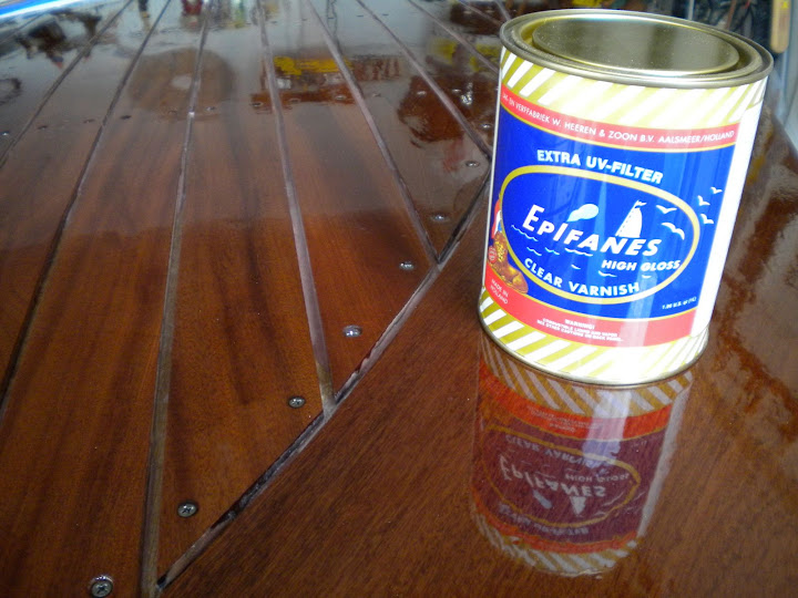

Roberta,
I think you will really like Epifanes. I have used it for over 20 years and love it. I actually rolled and tipped my Zip. I used West System foam rollers, cut in half and mounted on a 3" frame. On the sides I rolled stern to bow and tipped gunnel to shear, or at right angle to the roll direction. On the deck I rolled and tipped the same direction, with the length of the boards. I have found that a little Penetrol will help the varnish flow and Epifanes really needs to be thinned about 10%. I've always used Epifanes Thinner but I'm sure others will work as well.
I'm anxious to see what a superb craftswomen like you will come up as tips for the rest of us.

Look's really nice!! Everyone I know that has used Epifanes likes it, so Hopefully I will be among those.
