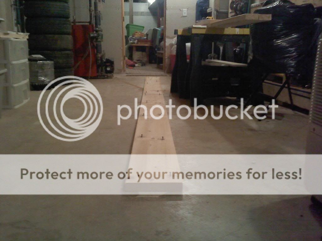

This thing is gonna be pretty well shoehorned into the basement. I'll have enough room, just going to be tight at the bow because of the manifold coming off of the furnace. The thought crossed my mind for a few minutes to just build it at the 12'3" length, but I figured I'd really appreciate the extra length for leg room, storage space, and ride comfort eventually, so I'll deal with it. I had to skew the entire boat slightly sideways in the workspace to get it past the furnace, but I've got at least a foot and in most places at least two to get things done in there. Besides the lally columns, there's even more room than that--the large shelving unit can be shuffled over a bit more during the planking process as I know that's going to be a little tight. Either that or I can take stuff off of the shelving to afford a bit more space.
Anyway, here's the first photo update--not much, but it's something. I used some concrete anchors and a drill bit to hold things in place. Unfortunately I couldn't get a 14' piece of lumber so I had to make this out of a 8' and 6' section of 2x8 for the building form. I clamped a piece of 2x4 to it to keep things nice and straight throughout the form, and luckily I managed to find some laser-straight boards to make these pieces out of.
I'll be waiting until I get my instructions sheet (which I lost) from Glen-L, hopefully sometime later this week, to complete the form. I have a couple 10' lengths of 2x4 and will likely have to purchase a couple more. Hopefully I have enough scrap 2x6 laying around for the form uprights.

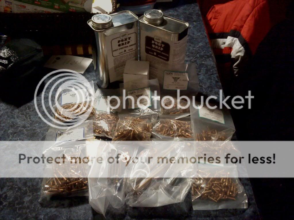

EDIT: Stumbled across this picture I took earlier when I first got some of my parts from Glen-L.
So far I have the FS hardware kit, the Poxy-Grip epoxy for everything besides encapsulating, all of the bronze carriage bolts, plans, lumber and screws for the form, foam and marine vinyl (slightly off white--cream colored, almost) for the seats, and trailer, motor, and controls from the donor boat (and steering parts, if I don't decide to go the teleflex route).
