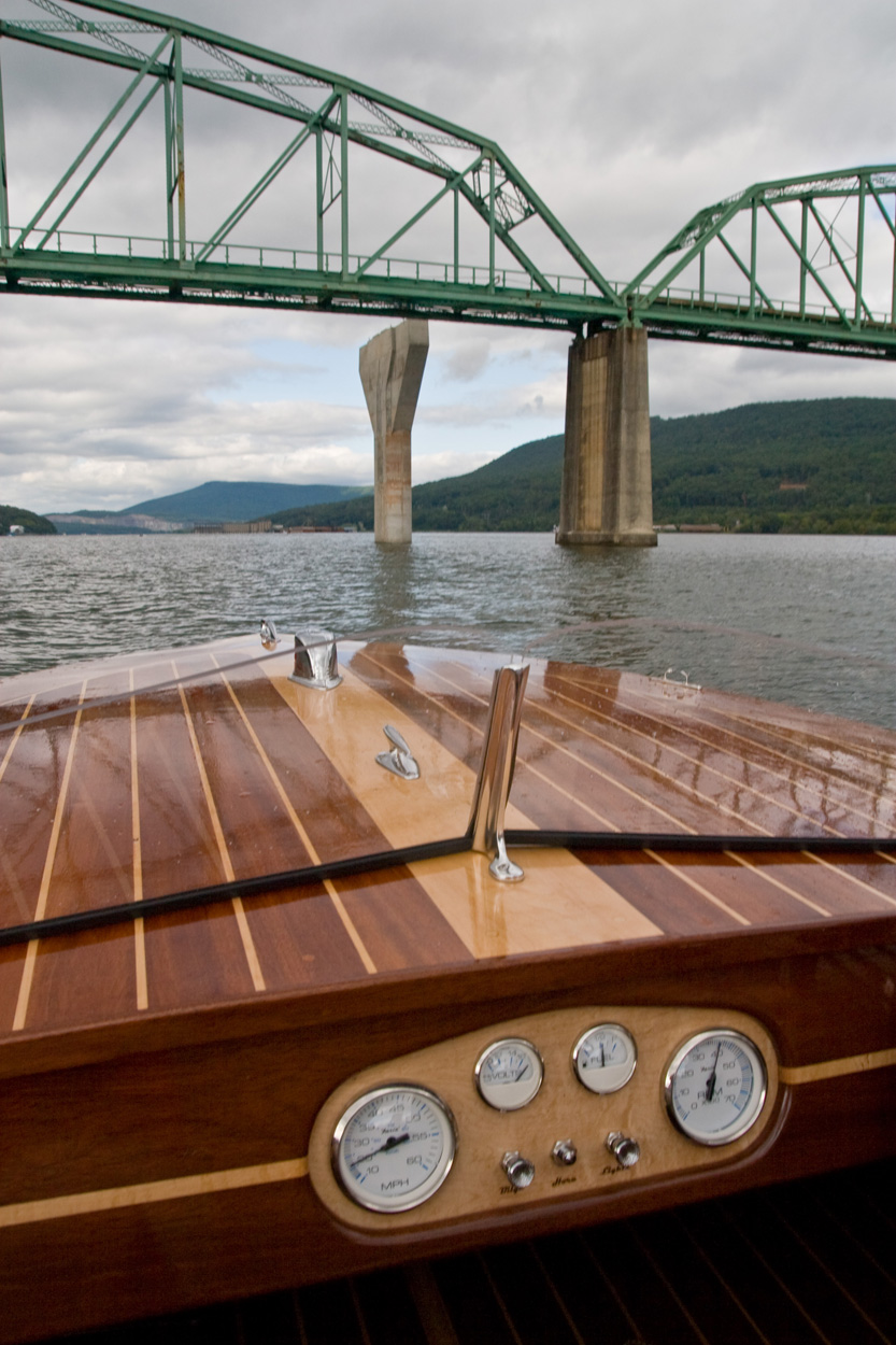

From the beginning of this project, the look of the dash was very important to me. I toyed around with different dash shapes and gauge layouts, and originally I wanted to mimic the look of the Riva Florida or Junior dashboard. Like a lot of people, I'm really fascinated by the classic Riva boats... but in the end, I felt that trying to mimick that look would just come off as cheesy.
The first time I saw the dashboard on Bob Brandenstein's Malahini, I knew right away I wanted to do some type of inlay.
Seeing Joshua Burks' dash in his videos was also very inspiring as far as making an inlay dash.
I also very much liked the layout Roberta did on Oliver IV. I know its a small detail, but I always liked the rocker switches she put just to the right of the helm:
So, yes, I did spend a lot of time planning it out & obsessing over it. In the end, I kind of combined the best of everything (or at least I tried to). The elongated oval shape for the inlay is my own little "tip of the hat" to the Riva Junior. I'm planning to use only one rocker switch to Roberta's two.
