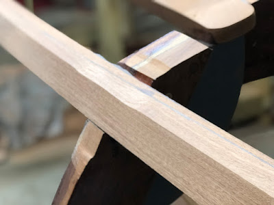

Here are some photos showing fairing progress since the summer. It's coming along... slowly, but surely.
Chine at Frame #4:
Chine at Frame #2:
Chine at Transom:

Your experience and persistence shows, Mike.

Coming along fine Mike. I remember the fairing taking quite a while for me as well. I think you're attention to detail will pay off in good fitting skins when you get to them.
