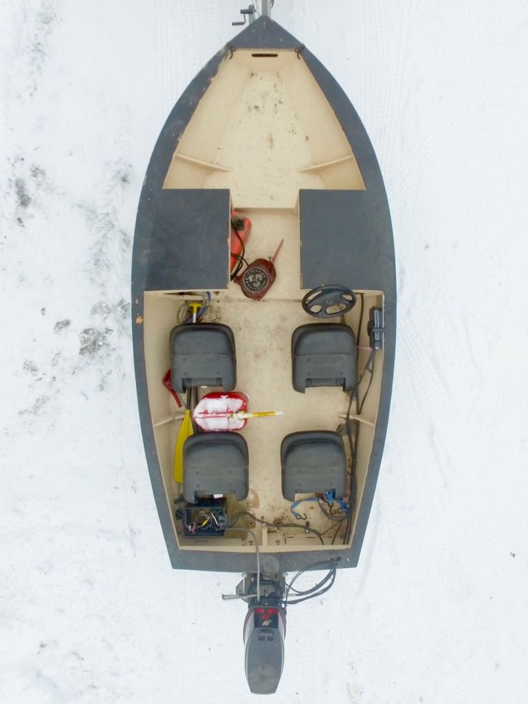

I'll second what Pullie said above regarding the control placement. Here is the layout of my FS. 25hp Mercury 2 stroke with a CMC tilt unit. Fuel tank is located by the front passengers feet, battery in the rear. I have a 6" planing extension on the transom and a fin on the outboard. It balances nicely in the water with two adults up front. It does well with a third adult in the rear. Four adults puts it at the most aft loading I would be comfortable both at rest in the water and getting on step. The 10% stretch allowed by Glen-L would be advisable for using the FS with this type of weight loading. 33+mph is max I've been able to get with one person, but I've never tried a steeper prop.
