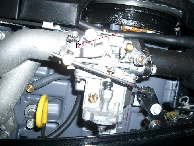

After that, I am pretty much out of ideas... I really think the best place to focus is the the throttle cable... I really think somehow the throttle is not going all the way to WOT. The butterly may open, but it may not be getting the full amount of gas
With the engine off push the throttle all the way open, and take a look at the gap between the parts highlighted below...
If that arm doesn't come close to hitting that pin, then you need to loosen that screw (that looks like a servo arm and connets to a bellows like on a Nitro RC motor) and adjust it so that when the throttle is all the way forward, the arm hits that pin and that little black thing that looks like a plunger is compressed fully. It's hard to tell from the picture, but if you look at your motor it'll make sense.
BTW, great boat!!!

the throttle linkage does hit the pin as it should.
