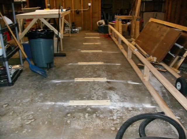

Screwing the building form into the concrete floor.

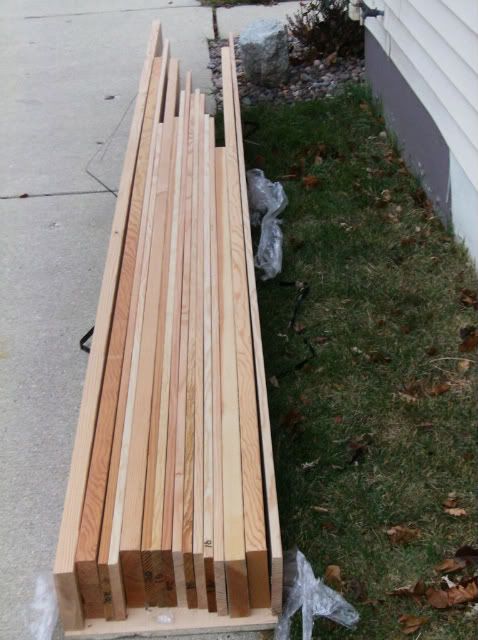

Here is some of my beautiful Douglas Fir.

If you don't mind I'm going to make a suggestion. Unless you like working on your knees and bending over all the time I would raise your form up higher. I'm 6'2" and don't like to work like that if I can help it. Here is how I did mine. I screwed my form to the sawhorses. Looking back now the only thing I would do different is to attach some braces between the sawhorses. Just my two cents.

I don't mind suggestions Chip; I actually need them once in while to stay centered. I've been struggling with the the anchor to the floor/elevate the form issue for a while. I really think that elevating the form is the right way to go but I was concerned about it flexing. It seems that you did well with the saw horses and bracing. Did you anchor them or was is OK not to?
PostPosted: Fri Dec 24, 2010 10:34 am
Posts: 1499
Location: Ridge Spring, SC
I didn't anchor them but you could. I think you would be fine with braces. Which ever way you go just make sure your form is square.
