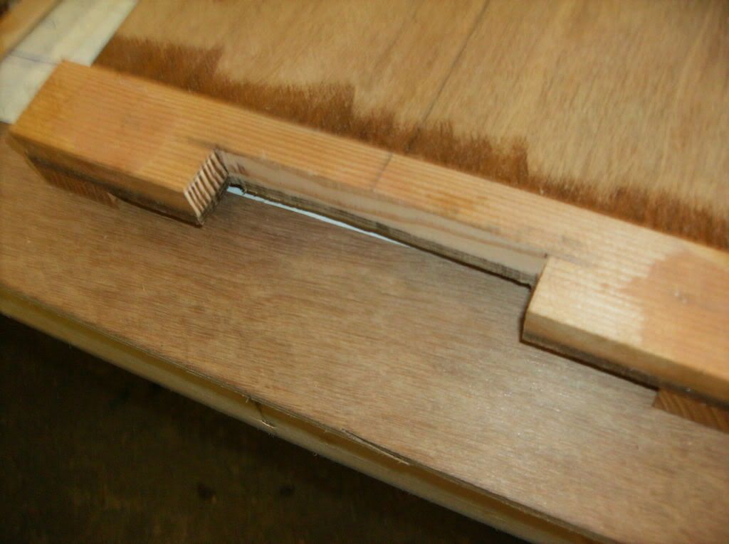

why not epoxy 1/4" shims into the too-deep notches. seems like no big deal

I am with Trisailor. Fudging some other measurement to fix a mistake can have unforseen consequences. Cut some shims and glue them in place. Do a nice job with scraps from the same timber and grain direction and it will hardly be noticeable.

I'm with Trisailor and track. Don't worry about this. Shim it and epoxy the keel so that it is even with your frames. If this is the only headache you have had, I would be proud. :D Besides once the plywood goes on nobody will ever see it. :wink:

If we all burned our boat projects because of a notch cut too deep or some other minor mistake, there would be bonfires all over the country! I would add a filler block to the B bulkheads as opposed to cutting everything else deeper...
Keep on building!

Thanks guys for all the feedback. 4 posts recommend shimming/blocking and 0 posts recommend cutting the keel deeper suggest you guys are right and I am wrong. Perfectionism has its pitfalls. So I will do as I am told and will keep you posted on the results.

Here is the solution we came up with. 1) Cut out the afflicted area. 2) Cut a filler block to fit. 3) Glue block in place. Thanks all for the feedback and votes of confidence.

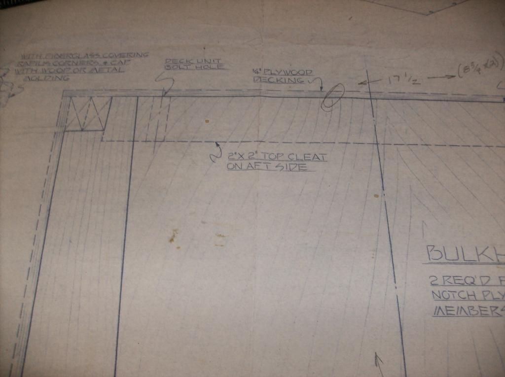

After measuring bulkheads B several times and checking and measuring the plans, I determined that I built the bulkhead 1/2" too tall. When I measured the plans, I incorrectly included the thickness of the hull plywood (top and bottom, 1/4" each). I am submitting this minor project diversion to remind the newcomer (and seasoned builder) to check and measure several times. Back to the drawing board!

Circled area shows where I incorrectly made the measurement. How could this have happened?

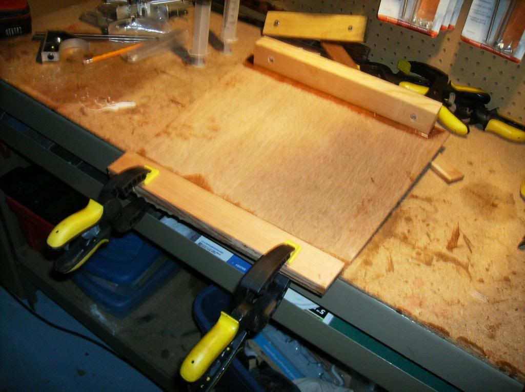

Still working in the shop every day in spite of freezing temperatures. I figured I owe a picture to show what I've been up to. Bulkheads B (take two) are cut out and sanded. The side frames are cut and trimmed. Next I head back to the basement for adhering the pieces with Poxy Grip.

I've epoxied the bottom frame members and top cleats to Bulkheads B. Working everyday in short increments of time. I seem to get more done that way and make fewer mistakes. Back in the basement as it is too cold for the Poxy Grip to cure outside.
