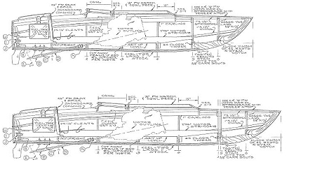

The following drawing might help to visualize the stretch :
The Gentry profile drawing is displayed at the top. The stretched version is represented at the bottom.
    • The profile drawing was cropped into two sections : body (frames 0-5) and stem (frames 5-6).
    • The stem was not stretched. It was copied into the lower drawing and the body was stretched slightly.
    • The stretched body is not to scale and somewhat distorted.
Note also how the boat’s center of buoyancy (CB) stays in relatively the same position :
                Diagram from Changing Stock Plans by Ken Hankinson

Paul,
you seem to be pretty good with the computer drawing thingy.
Please take the lower drawing you have above (the stretched) and align it with the upper (original drawing). align it with the constant being the bow. (the stem sections are not stretched)
when you align both drawings even with the bow, you see how the engine moves aft.
think another way.....
1. Look at the CB of the original, see that (for sake of discussion) engine sits on frame 3.
2. Count how many frame stations get stretched aft of 3.
3. Count how many frame stations get stretched fwd of 3.
4. remember that 5 & 6 are not stretched.
5. Which end has more ADDED buoyancy to compensate for?
6. move the engine accordingly.
What am I missing here?

You aren't missing anything ! It's a matter of perspective e.g. looking at it from the stern, CB or stem.
My drawing is a bad hack but when compared to Ken's drawing (stretched stem) it shows that many build options are available.
What is important is how the boat’s center of buoyancy (CB) is affected.
