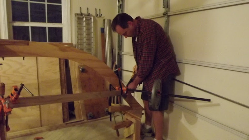

Chines after "steaming":
Not perfect, but definitely help make the bending easier.
Then I used somewhat of a Rube Goldberg to get the chine into place for cutting:
Consisted of the bar-clamp "trick" to get leverage on the chine, and then a 25 pound weight on the bar. The weight could be slid back and forth to get just the right amount of twist, and then locked into place with small spring clamps. Then I used a band clamp to pull the chine up and into position.
Worked pretty darn well... :)
Jeff
My Celerity build.

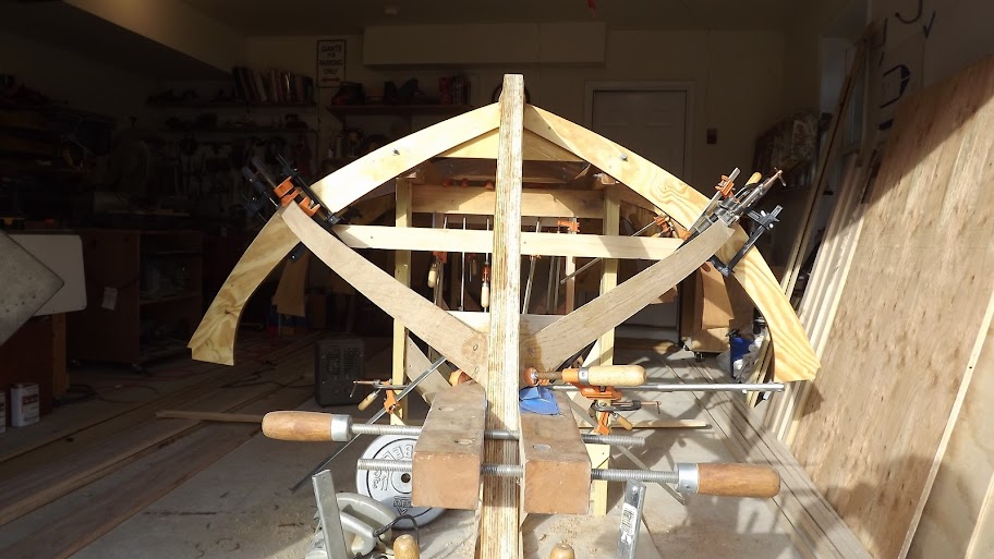

Well, now that the holiday madness has past, I've finally been able to get back to it.
Got the chines and first layer of the sheers installed.
I also installed some chine blocking and some small gussets where the chines meet frame #3. Maybe overkill, but there seemed to be so much stress in the chines up front, that I wanted some extra reinforcement.
Chines:
Sheers:
Blocking/gussets:
Jeff
