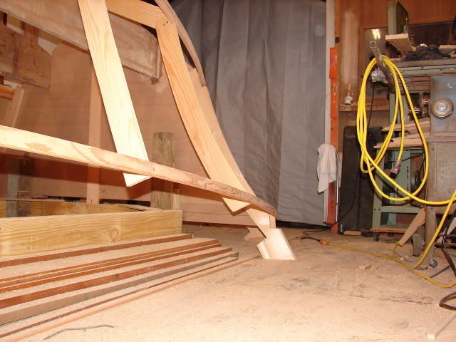

Okay lets try this again. Its important to get the first layer flat, fair and uniform. From this layer the shape is tranfers and telegraphs to the top layer and you want to keep fairing or filling to a minimum. With the shape that you have created you have a lot of things going on. While you may get by with narrower plywood panels on a bias, full sheets of plywood will not plank the sides with the compound and "corkscrew" shape that you have ended up with. For me personally I have never been able to use full panels foward with the sweeping sheerline incorporated with any real amount of flare.
Hopefully this shot show the many angles and shapes which is generated by the flare and sweeping up and out of the sheerline.
This is the way I handle the foward most part of the sheer, which ends up in a vertical postion since you cannot really torture a twist into any sizable batten.
Its important that the edges lays flat along the curvature of the sheer batten which is continously curving in the foward area. Depending on what material you are using, thin plywood probably for you, 1/4" can be coaxed to cup and held in place until the generous glue cures behind the initial layer.
If you take a closer look at the veneers you will see that I also use temporary strips to keep the edges aligned until the glue dries. Make sure you glue the edges and if at all possible clean the extra on both sides that ends up squeezing out before it cures. I also use temporary plastic sheet or plastic tape on the faces if need be so that the pieces will not stick. I also use sheetrock fine thread which pulls the seams in line. When I finish the glue ups I cut the edges uniform with the sheer batten back to where the planking lays flat and then glue up one more piece of the batten to the outside of the existing batten butting it up to the plank thats lays flat further back on the sides. Pictures on that later in the week..
