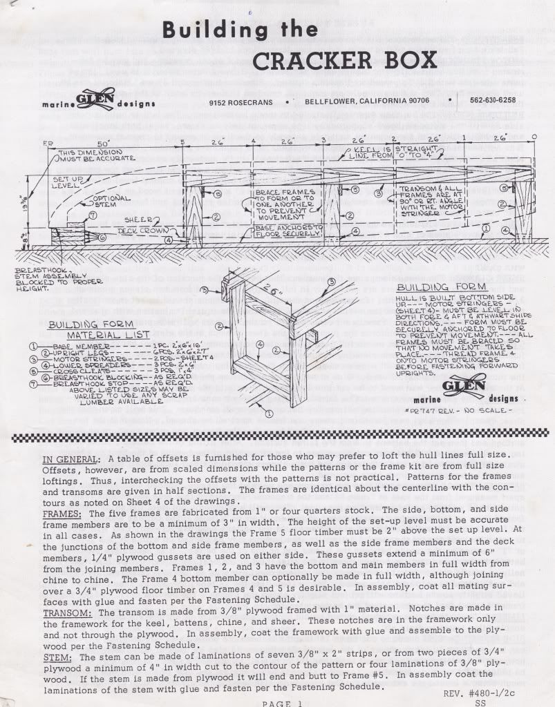

OK all, started back on my crackerbox. ?s for those who have built one. I am confused about the setup level. On pg 1 of "building the c-box", it looks like its 1 inch lower then the bottom of the motor stringers at the base of the 1 inch groove for the frames. But on pg. 4 of the "drawings" showing the stringer, it looks like it may be 3 inches " lower then the stringer bottom, before the bottom fwd. section gets beveled. Any help to clarify is appreciated!

Post by fergal butler » Wed Oct 21, 2015 1:50 am
The height of the build form can be changed to suit your self, you might need it a bit bigger to give yourself enough room to slide underneath the boat or to save your self from bending down too much, don't go too high as you will want to be able sand in as far as the keel without getting on a stepladder :D
Once you have from the setup level to the bottom of the stem measurement right you should be ok, the set up level is 1" into the stringers as this will be the floor level when all the frames are in place.
I think thats right anyway :D it's been a while :roll:
