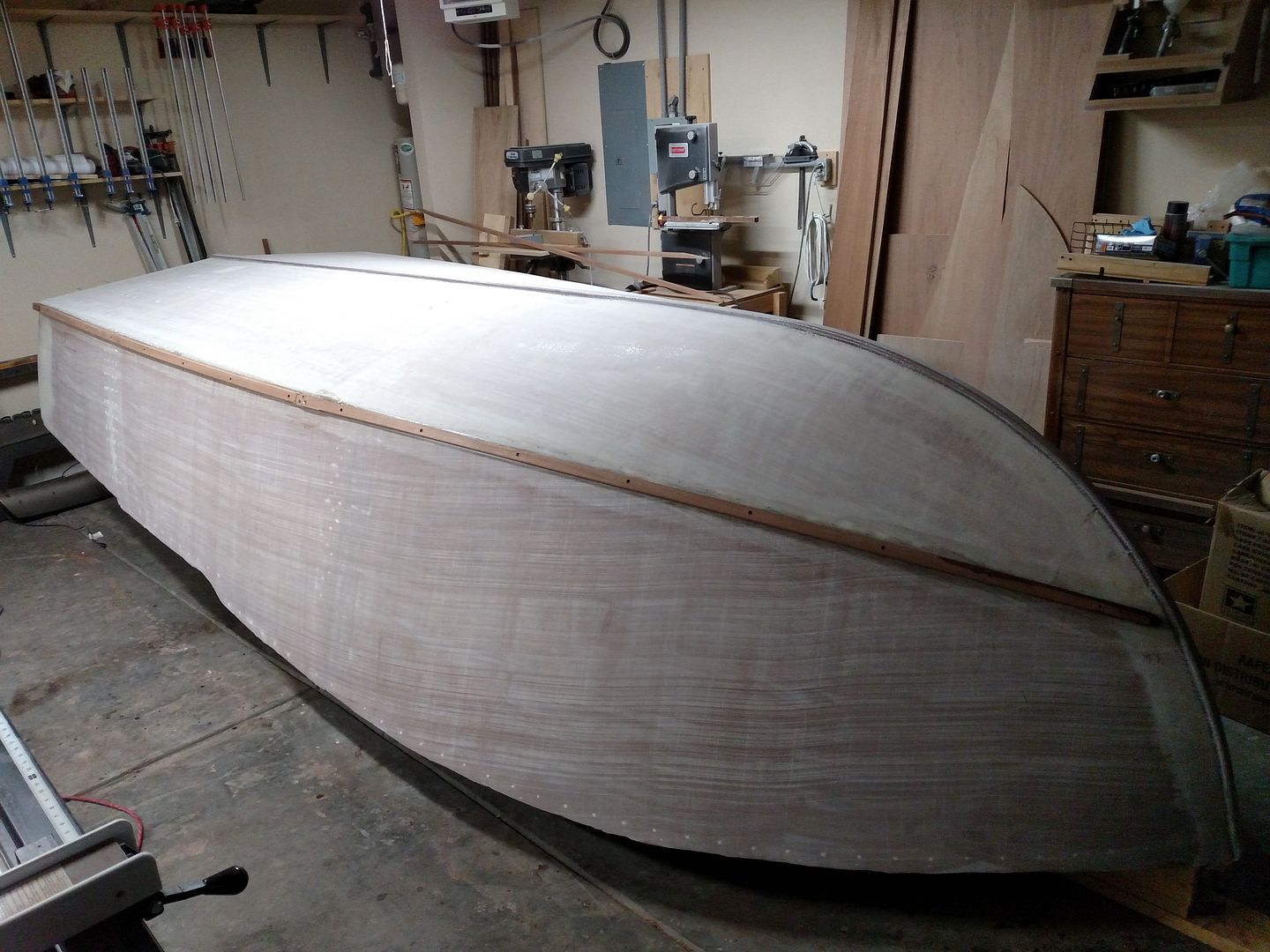

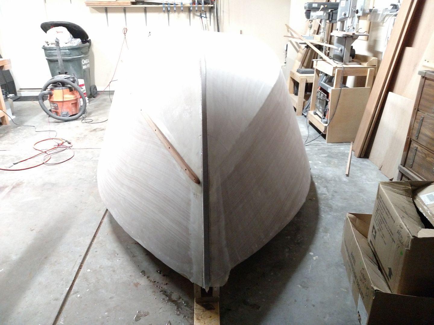

Pretty well. I guess I'm due for an update lol. Anyway since my last update I've completed the fiberglassing, the keel strip and as you'll see I got the first spray rail on today.gap998 wrote:How's the build coming along?
For the fiberglass I did a combination of 10oz glass and a layer of xynole. I wanted the bottom in particular to be as bulletproof as possible. I anticipate beaching the boat frequently and wanted the bottom as tough as possible. So what I did was apply a layer of 10oz glass to the entire hull. Then I installed the keel strip. Then I put a layer of xynole covering the bottom panels and the keel strip all the way up to the bow. My research shows that the xynole is very similar to Dynel and is extremely abrasion resistant so it should really protect the keel strip and bottom panels really well.
In hindsight I should have just done xynole only on the entire hull. After seeing how thick it is and how much resin it soaks up I'm confident it would be very very tough all by itself. I also found it very easy and forgiving to work with. It can wrap around a really tight radius easily. And it drapes and conforms to the hull really well. The only catch is it will float on the resin if you puddle it on to heavy. I found that spreading the resin exclusively with a squeegee instead of a roller eliminates that issue though. Anyway for any potential or future builders out there I highly recommend it if you plan to paint. Obviously it's no good for bright hulls.
Anyway I got the weave all filled up with resin and sanded everything down and now I'm working on the spray rails. As you can see I have the first side mounted. I'll get the other side tomorrow.
Next step will be putting some nice fillets on the spray rails and getting them faired in. I also need to go ahead and sharpen up the rounded edges on the transom. Then fairing priming and paint.
For paint right now I'm torn between supermarine or interlux. They are the only two I have found that offer a paint rated for long term immersion. This boat may do stretches of a week or more in the water and I'm just not willing to put topside paint on the bottom. After a ton of searching I've found two options for a bottom paint rated for long term immersion that are not biocide or ablative paints. The first is interlux VC performance epoxy. The other is supermarine ironsides.
The Iinterlux VC is available only in white so I would only carry that up to the waterline. I would have to do the topsides with brightsides or perfection because I want a dark navy blue color. The benefit of going interlux is that those products are very popular and well proven to provide good results. The draw back is the need to precisely mask off and identify the waterline and make the transition between the VC and the Perfection.
If I do the supermarine paint I can just put the 2-pack ironsides on the whole thing. No need to find the waterline and make a transition between two different paints. Downside is there isn't a lot of info or experience with this stuff so there is some risk. There are some folks who report good results though so im considering it.
In fact I'm leaning towards the supermarine right now cuz it looks like I'm only going to paint the bottom before the flip. I need to get her flipped in order to fair the sheer line and install the rub rail before I paint the tops sides. I figure if I go with one color and do the whole thing with ironsides I can just paint the bottom up to the spray rail and then once I'm ready to paint the topsides it will be very easy to tie it together. So we'll see. Still have some time to think about that.
Anyway, with no further ado, some pics.

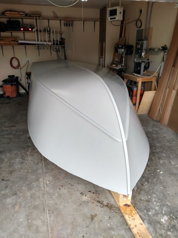

After lots of fairing and sanding today was a major milestone. First coat of primer. I'm using supermarine etching primer. Planning to topcoat with supermarine ironsides.
First coat rolled on really nicely. Fumes are intense though. I'm gonna spray the second coat. Didn't want to spray due to the mess and waste but it will be much much faster which means less time sucking up the fumes. Hopefully my gun will spray the primer well. We'll see in about two hours.
Re: Overniter in SC
Thanks! Second coat looks even better. Bought a good respirator and sprayed it. Got much better transfer efficiency than expected and went pretty quickly. Should have sprayed the first coat. Oh well. All turned well so far. Gonna let it cure out and get to sanding again.
