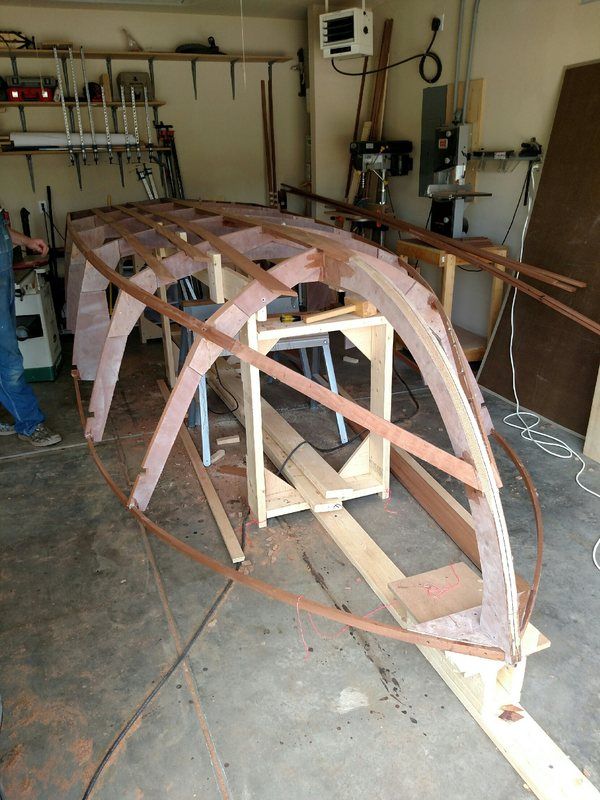

Post by Adrock1 » Fri May 20, 2016 4:40 am
Hey all. Well as you can see I've been making some progress. Frames are done and mounted on the form, chines and keel are in place and mostly faired. Started on the sheers now.
That's what leads me to my next question. The Overniter has kind of a double sheer. The main sheer clamp runs from the transom all the way to the stem. The "raised sheer" which lies just a few inches above the main sheer runs from frame three to the stem. So from frame three forward there are essentially two sheer clamps.
The plans indicate that the main sheer should be glued and screwed to all frames but not connected to the stem until after planking. I can only assume this to ensure it follows the contour of the planking. For the life of me I can't figure out how I will properly fair that portion of the sheer with it flopping around loosley. Especially since the sheers for this boat are made from two laminated layers since the full thickness won't make the bend. If I try to attach it to the stem it will be a real chore to match the curve of the planking and fair everything in together. I would need to add a second breasthook of sorts to spring the sheer out in much the same fashion as the raised sheer in order to get close to the right shape to the bend.
What's really got me stumped though is why I even need to carry the sheer all the way to the stem. The raised sheer goes from frame three forward. If I let the main sheer go from the transom and extend a foot or so past frame five and simply taper off like I will with the bottom battens this would all be very simple. And the two sheers would overlap by at least three frames ( #3,#4, and #5).
I really don't know how to proceed. Thoughts?

Post by Gayle Brantuk » Fri May 20, 2016 8:45 am
Adrock1--both sheers attach to the stem per the instructions. Where are you seeing that they don't?
