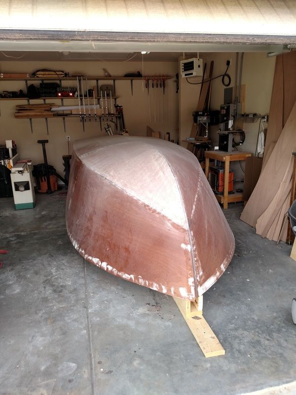

Post by Adrock1 » Thu Jul 07, 2016 4:50 pm
Been a while since I posted but I've been busy working g on the boat. Planking is all on. As you'll see I've got all the screw holes plugged and a coat of epoxy on and now is sanding. I'm hoping to get started on fiber glass before long.
This leads to yet another question. How much fiberglass to use.
The plans call for one layer of 7oz. I'm particularly concerned about abrasion resistance though. This boat will get beached frequently. I want it to have good resistance to scrapes and gouges and punctures. And just generally speaking I want the surface to be tough. I don't want to have to worry about a scrape or gouge going through to the wood and needing immediate attention.
So the question is, is there any value in putting an extra layer of 7 oz glass on the hull? Or perhaps putting down just one layer of heavier glass like a ten ounce.
Also the plans call for a keel strip. I would like to increase the protection there as well. My plan is to apply this on top of the fiberglass but then apply a layer of Dynel over the keel strip. It's supposedly much easier to form to sharp bends and it's particularly abrasion resistant. I would radius the edges of the keel strip and put a fillet at the junction with the hull.
Last question is in regards to strakes. Would anyone recommend them for this boat? Will the keel strip be sufficient to prevent sliding in turns? I will likely use this boat to tow a tube or skier if that makes a difference.
Anyway just wanted to share update and get some advice on this next step.

Post by Bill Edmundson » Thu Jul 07, 2016 5:17 pm
If you are worried about abrasion, use xynel fabric instead of glass.

Post by Adrock1 » Fri Jul 08, 2016 6:30 am
Milky is no problem as I intend to paint the hull. The only brightwork will be the deck.
So would this totally replace the fiberglass on the hull or be in addition to the fiberglass. Can anyone elaborate on the potential drawbacks to using this xynole stuff? Will I be sacrificing any strength or rigidity in the hull. My understanding on what little reading I've done is that Dynel and xynole are good for abrasion but now for structural applications.
Would it make sense to fiberglass the hull per the plans and then just put a layer of xynole over the fiberglass on the bottom only. Perhaps covering the keel strip since it apparently takes sharp bends well.

Post by DrBryanJ » Fri Jul 08, 2016 9:32 am
From what I understand from reading the posts here, fiberglass is for abrasion resistance as well. It doesn't add to the structural strength of the boat. So using xynole instead will not change the strength. Xynole does require more coats of epoxy to fill the weave. Would add to the cost and finished weight. Is it enough to be concerned about? I don't know.

Post by Bill Edmundson » Fri Jul 08, 2016 10:18 am
Actually xynole is a fine weave takes less on the fill coats. I did a test with the edge of a "calibrated" fire brick. It went thru the 7 oz. glass in 10 to 12 strokes. The 4 oz. xynole, I quit at over 100.
The down sides are that it cost a little more and it is difficult to cut.
I did the hull of the mini tug/dingy and used PVC for trim. You can hurt that thing.
Dynel is a very good product. I have several white water paddles made with it (Norse). I have use the paddles as shovels and to cut brush in a campground. And only God knows how many rock they hit!
