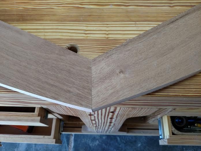

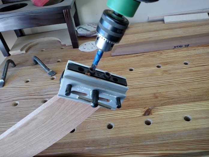

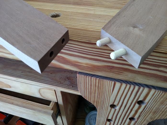

Alright guys. Spent a little more time on frames today. Most of the frame parts are all cut out. I'll order glue, some resin, and some screws tomorrow. in the mean time I worked on the dowel joints I described. I used a self centering doweling jig to bore holes where all the frame members meet. Some little 3/8" dowels will then align everything for glue up. I use this thing all the time in my woodworking projects and its a pretty handy little device. Here are the pics as promised:
The jig clamped on a frame member with the drill in place:
Here you can see the holes bored in the mating parts:
And finally here is the joint all closed up:
It really works pretty well and should keep things from shifting around during glue up.

I got that doweling jig at woodcraft. Very handy and not expensive. I think it was like $40. It works perfectly in situations like this. Doweled joint like that aren't particularly strong but it does add SOME strength to the joint. The benefit is it will keep those butt joints from sliding around while I get the gussets screwed on. Everything should line up perfectly.

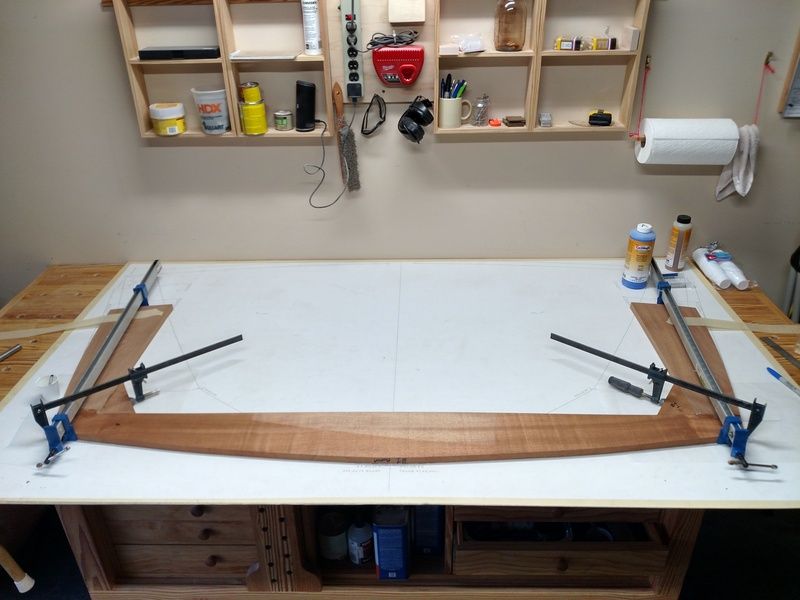

Post by Adrock1 » Mon Mar 07, 2016 6:14 pm
First frame glued up. Dowel construction worked great. I'm also really liking using the silvertip gel magic. Not having to clamp things up so tight like im used to with wood glue is nice too. Just a couple clamps on each joint to close the joint up and let it set.
I plan to get all the frames glued up like this then grind off the squeeze out and glue/screw the gussets on.
