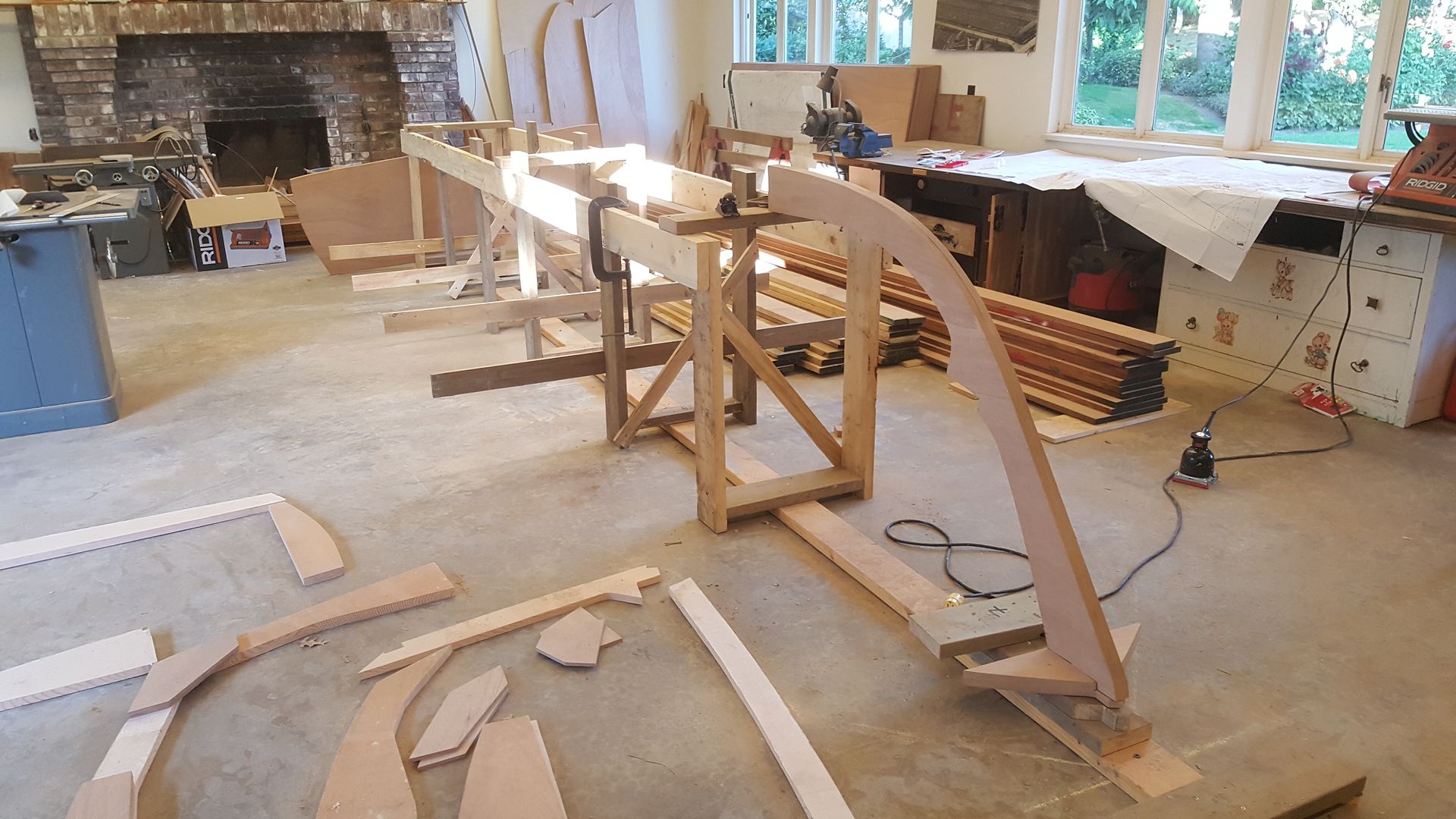

Transom is now cut out! Still needed to be sanded to perfect shape but I thought it was time to celebrate all my progress with a beer!
Here is a dry fit of the transom frames in place
Loved seeing the rough overall size for the first time!

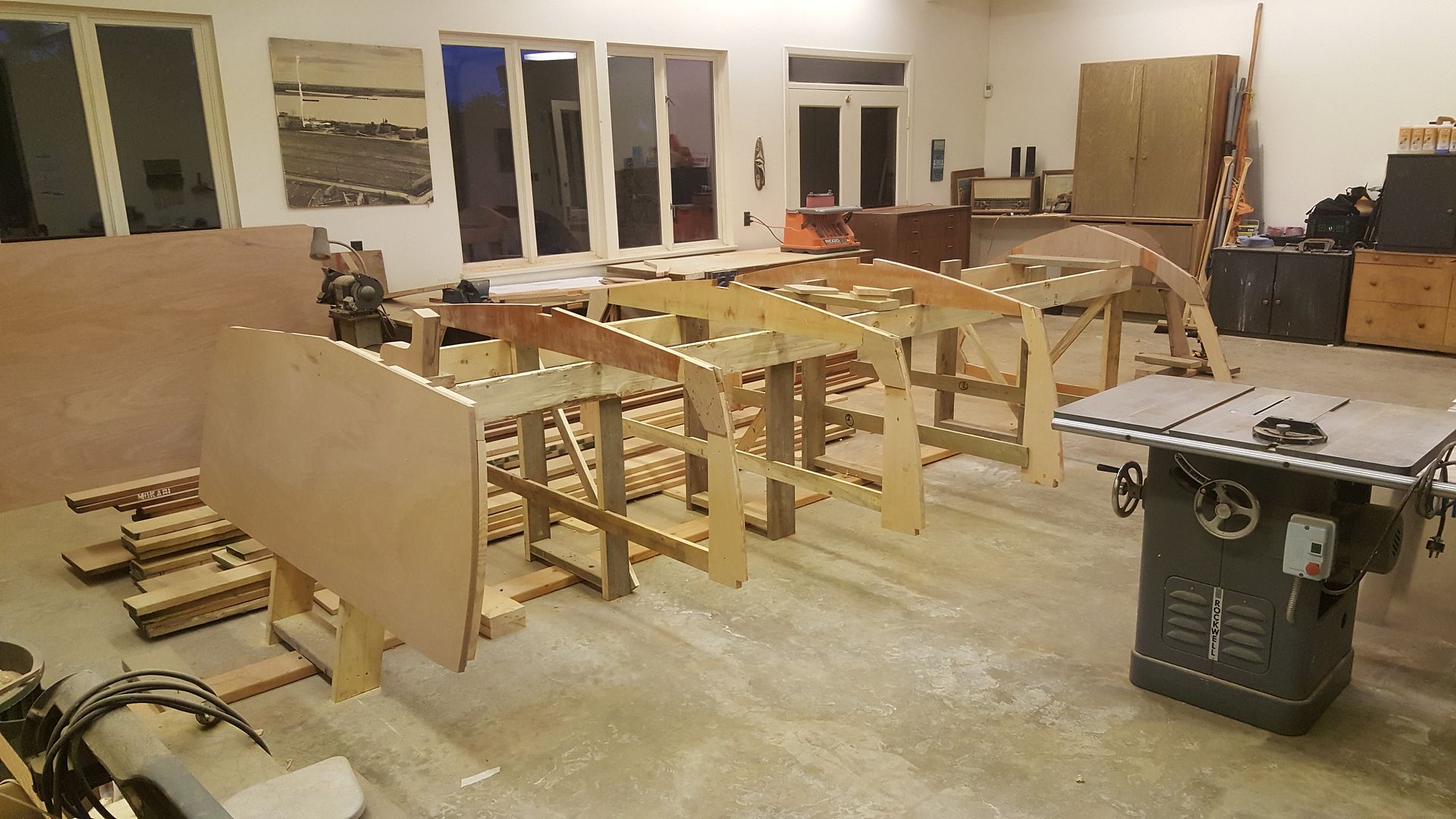

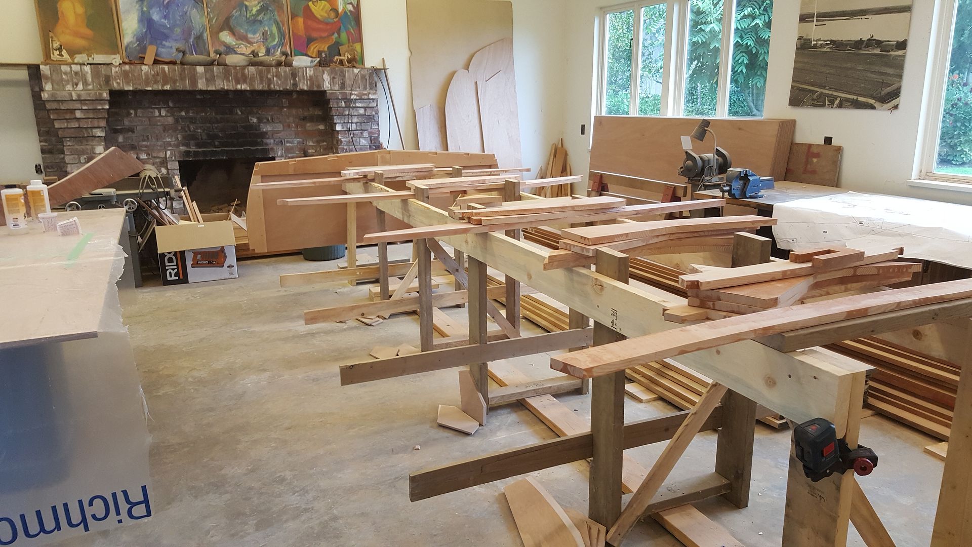

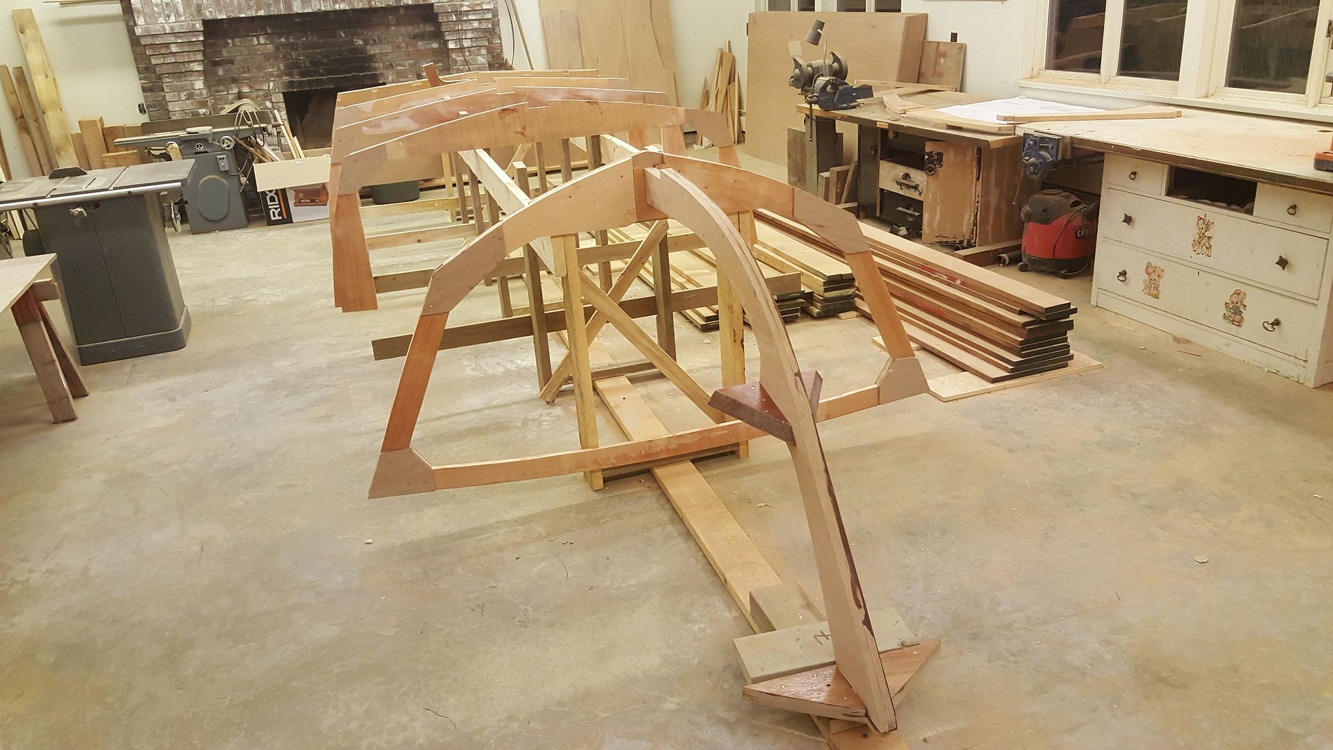

It's been a very busy week at work and I wasn't able to get much done on the boat :( The last frame was glued which meant it was time to start mounting!
With the help of my laser level I went down the line and fastened them each to the build form with two screws.
:?: QUESTION: what would everyone suggest I use to fasten the tops (currently upside down) of each frame to the form. My second question is, after planking the boat, how do I get under there to unfasten it? Do I pop in before the last of the planking goes on?
Next up is finding some time to build a couple new saw horses for a table saw outfeed.
Re: My (Sort Of) Sea Knight Build
Posted: Mon Oct 03, 2016 12:00 pm
by hoodman
None of the tops of my frames are fastened to the building form. I just made sure they were plumb when I was installing the sheers. Nothing wrong with attaching them, however. After planking you'll just have to lay down and shimmy under there to undo them. I've been under my boat a few times since installing the planking. Not fun, even after I swept out under there. If you have a creeper you can probably roll underneath.

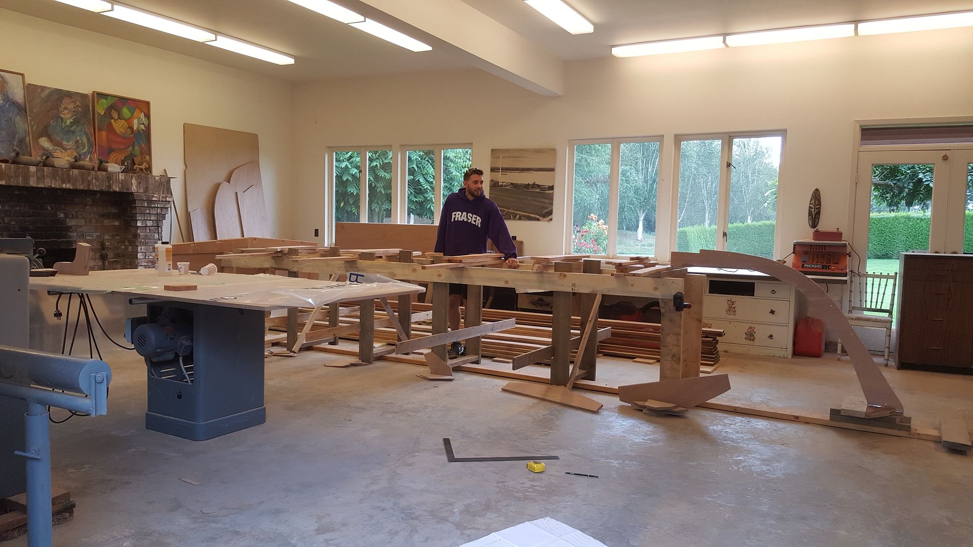

I managed to bang out two new saw horses for my table saw out feed. Even though they aren't winning any awards for style or beauty they work great and so I got right down to business!
I spent the better part of an afternoon setting everything up and that entire evening ripping my white oak boards for the keel, battens, sheers, and chine! I'll be honest, I'd been putting off this task for longer than I should. While I've always been comfortable using table saws, I've never ripped such long boards before and it was a little intimidating.
It felt so good to start seeing the bones of the boat coming together that I couldn't help but take another selfie!
After several more hours I'm happy to report that all my long rips are now DONE! :D
