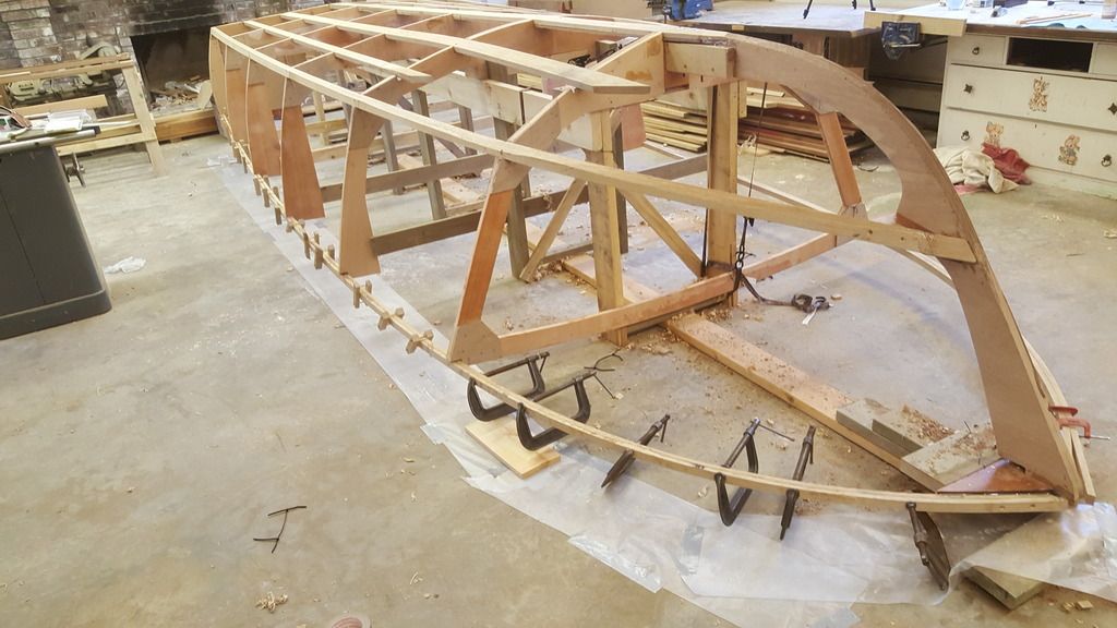

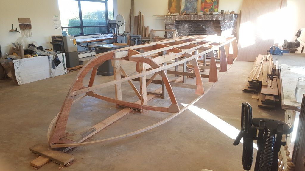

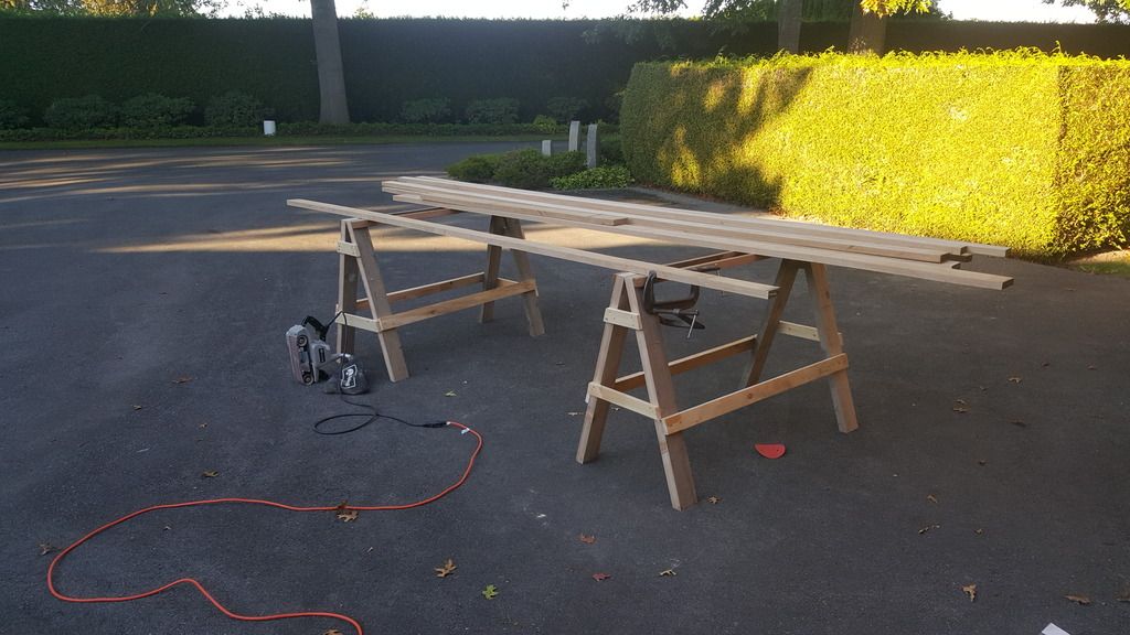

I use sawhorses as out feed supports too. I really should re-build mine so that they will be the same height as my table saw like you did. I always have to put additional blocking on top of them and then a sheet of ply to get a good support.

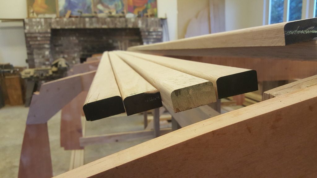

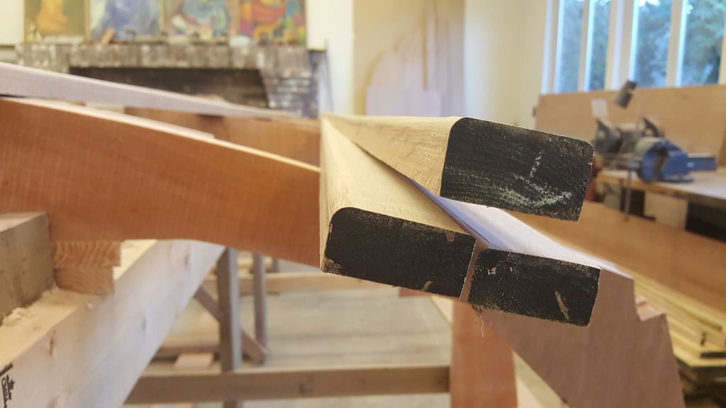

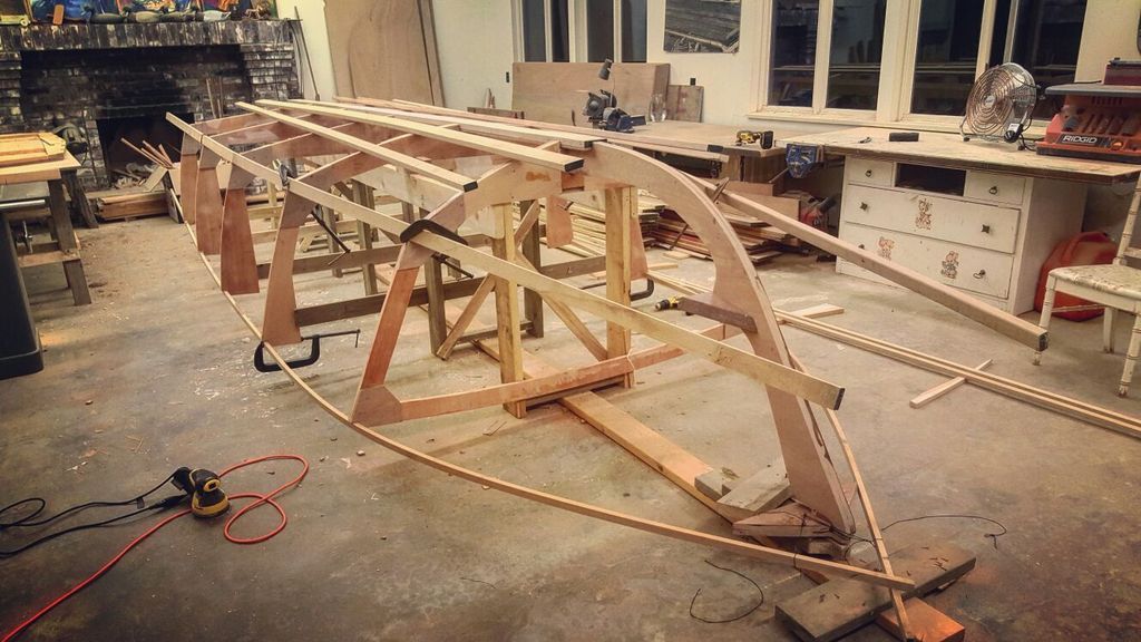

This day was spent lightly sanding my new battens, chine, sheer! Once sanded I pulled out the router and added a nice rounded edge to the interior portion of each piece. While my boat isn't bound to win any awards for skill or beauty I was really impressed with how they looked!
Note that the ends will be cut to size so I didn't finish them off

Look's Great!! Something about a rounded edge on boards that is very appealing.
Re: My (Sort Of) Sea Knight Build
Looking really good. Your knees will really appreciate the rounded edges when you flip it over and work on the inside. Skip

Hot diggity! Posting these updates has become one of my favourite parts of the build as it's amazing to see how much progress I've made. Still a long way to go but motivation is high and I'm really enjoying this part of the build.

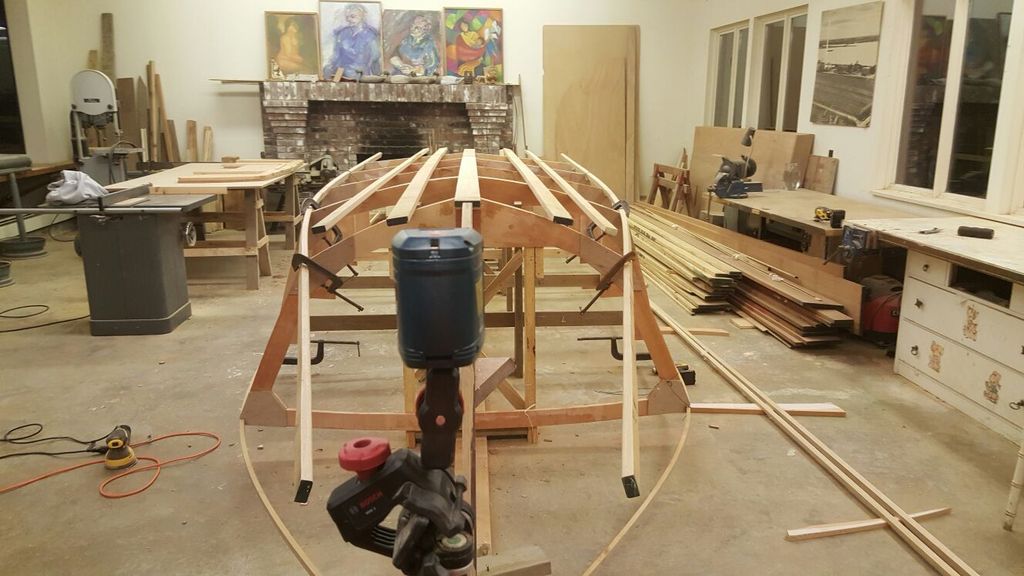

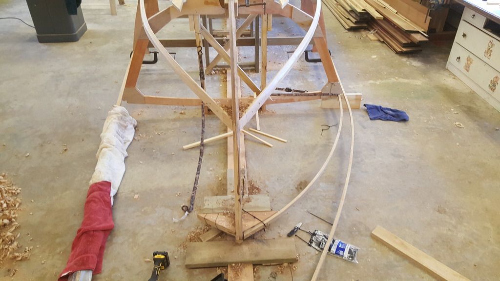

My first time cutting and gluing scarf joints was...a real learning experience! I apologize for not having many photos. I used a combination of my table saw with a scarf jig, my power planer, and hand planes to get all the scarfs cut. Then glued em up to get the length I needed for the chines, sheer, and battens.
I got my keel laminated and then bolted it to the stem and transom knee (dry fitted only)

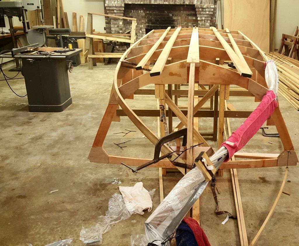

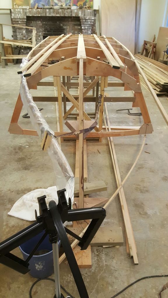

Then came the fun part! STEAMING!!!!
A HUGE thank you to the many people on this forum that have shared their tips for how best to steam and bend (Carl - thank you for all your documentation) I used my garment steamer...which is quite a little beast as I use it to steam my work clothes each morning, and it worked like a charm! I used thick plastic wrap to create a sleeve and plugged each end with a rolled up towel and zap straps, shoved the steamer hose in and turned it on. Each chine took about 45min before they could be slowly eased over!
The notches in frame 5 still need to be cut at the right angle but then the chines should fit perfectly into place!

Fraser, looking good. Glad my documentation could be of use. I learned the steaming trick on the Internet and it was tailor made to do the job you and I used it for.

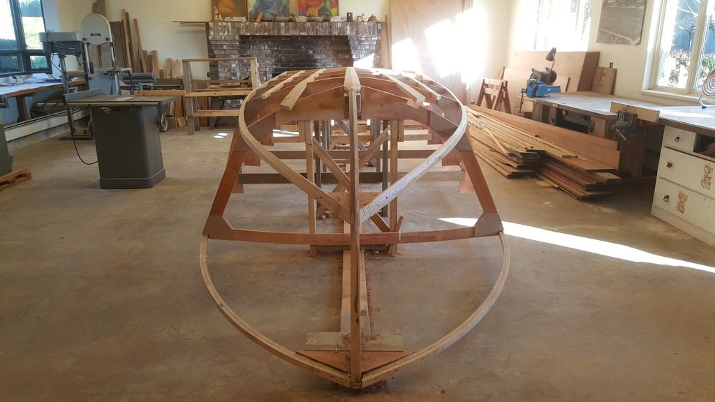

After getting the keel and chines faired up I cut out all the notches for the battens and then it was time to add the sheers! Same steaming process was used that I did for the chine and it worked like a charm.

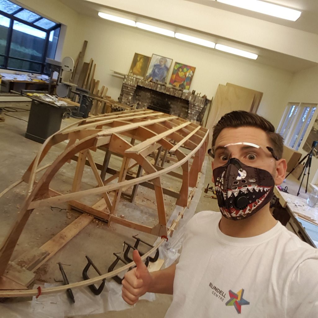

Here I am super excited to be in the shop rocking my new respirator. I'll admit that i've been terrible about consistently wearing my respirator while working on the boat but with this thing there is no reason not to. It's so comfortable, looks awesome, and has a HEPA with active carbon filtration that is good down to .1 micron!
Both laminations were bent at the same time and then left to rest for 24hrs.

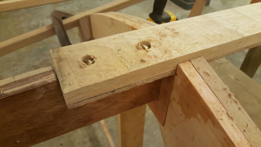

Then came time for gluing, screwing and clamping! As you can see I don't have a ton of clamps and I couldn't convince my wife that I needed to buy at least 20 more, so I ended up making my own with screws and some scrap oak! I highly recommend this if you're in a pinch and need a few more clamps
