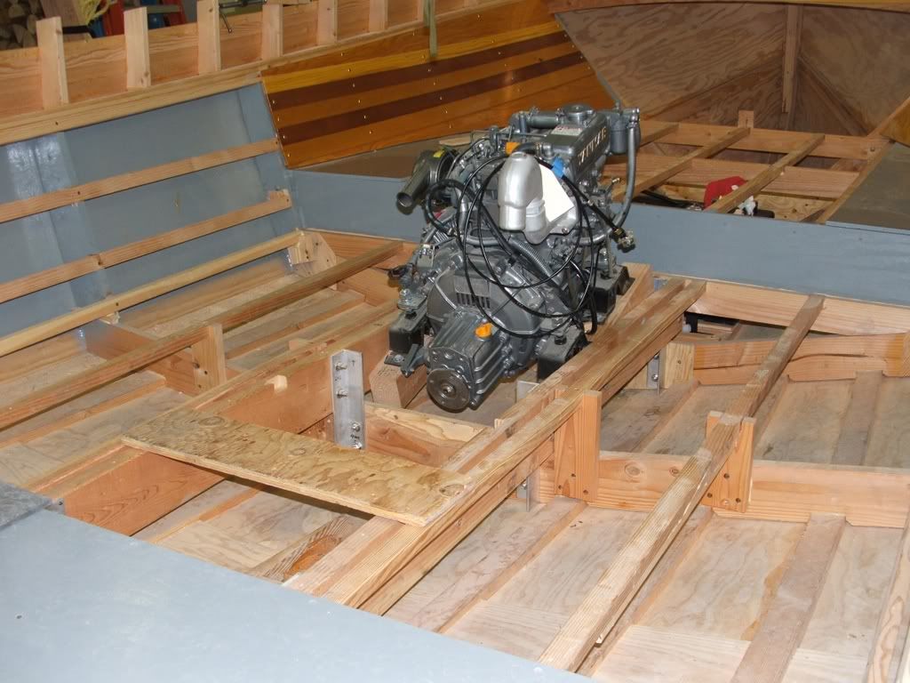

Hello and long time since I've posted, I've been very busy completing the Bo Jest.
Question: My exhaust riser is located 14" above designated water line (DWL) and the deck supports you see in the picture below are just about water level. I'm planning on going straight down below deck so the exhaust can fill with raw water then be pushed upward to a point just above DWL at the transom, basically duplicating the effect of a lift-type muffler w/o the hassles. See any possible problems with this idea?

Looks like a Yanmar to me!
I'm not completely sure I'm clear on what you're saying. But, my exaust will not be all above the waterline either. So, I'm hoping for the lift effect also.
I can't get the picture to post. But, I cut and pasted it in the browser.

Postby Jones » Thu May 03, 2007 1:55 pm
Bill Edmundson wrote:Looks like a Yanmar to me!
It must exceed the size limit, if there is one.
Detailed explanation:
1) The output from the exhaust riser sits 14" above water.
2) The intended final exhaust point sits about at water line.
3) Routing would go from 14" above water to about 4" below water and then exit about level with water... in theory this should protect the engine from flooding and still form a "pool" so the exhaust is cooled and quieted and would be dumped every time the boat is hauled out.
I'm basically ready to go with my plan, just thought I'd bounce it here and see if anyone saw glaring fault.
Thanks.
