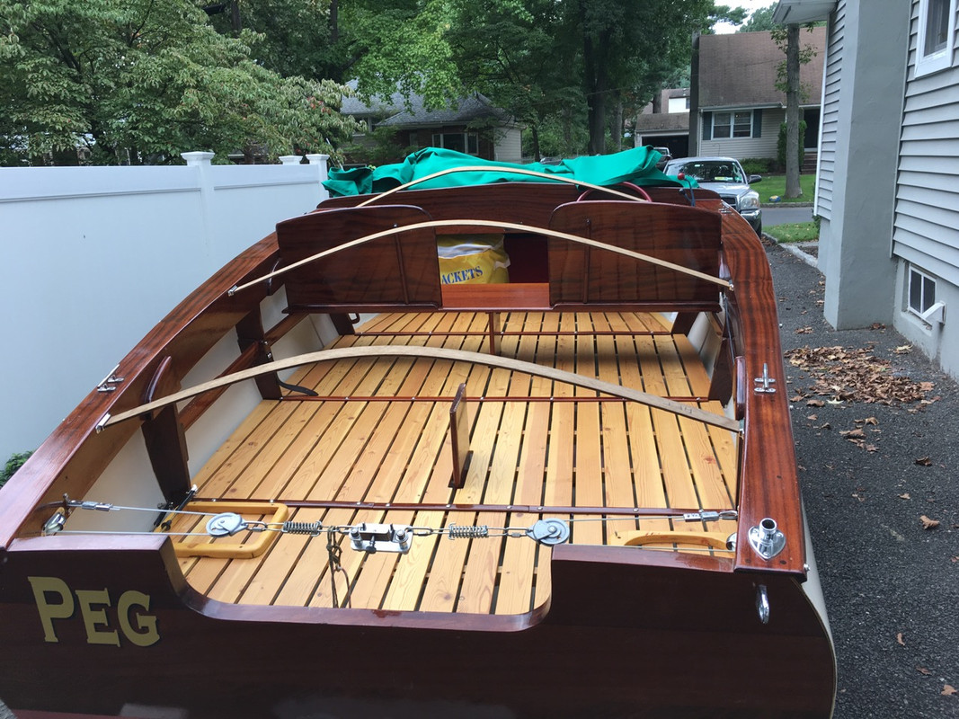

What do all of you use to make boat cover battens? These are mine, they're made from leftover 1/4" Meranti plywood. They're 2 years old and showing their age badly. The one fore is starting to crack in the middle.
As a kid, I remember the cover battens on our boat lasting forever; we surely never replaced them. So there's got to be something better than what I'm using.
Ideas?

Try one of the flavors of mahogany. I’ve had some of ash also that did ok but were varnish coated.

I used fiberglass sail battens.

Hi Mark, really nice boat! Those bows can be found at marine supply places for example at West Marine:
https://www.westmarine.com/buy/attwood- ... ogle-_-GSC
I have had both wood and fiberglass, both worked well though I think the fiberglass is prone to chipping on the ends and puts more pressure on the boat, trying to push the sides out. Totally up to you whatever you want.

A couple lams of thin wood would help keep it from splitting.

I had a aluminum one on a boat I had.

I have some leftover sapele. Is that "mahogany-ish" enough?

Mark-NJ wrote:I have some leftover sapele. Is that "mahogany-ish" enough?
Should be perfect if grain is not too wild.

Howdy, I had a badly bowed mahogany floor board i saved and put 1x1 oak along the sides for rigidity, to make a backbone for the cover. My generic cover still sagged between the windshield and rear seat so before I cover it I lay a 3'x4' piece of 1/4"ply on each side, they lay on the oak lip and are held there by the cleat. Bob

I use 1/2 pvc ent works great and its cheap. even made some end caps out of hdpe I had left over. I just use some spring clamps to hold them in place. works great and it cost about $10 going on 4 years now. no complaints.

Sched40 PVC! That's an awesome idea!

Oh yeah! 1/2" Sched40 for the win!
I heated the ends with a heat gun, then pressed the softened pipe between 2 metal plates. As it was hardening, I lifted up on the pipe to give a slight bend to the now-flattened end. Then I sawed the ends to length, with an angle to meet the boat's gunwale.

Glad that worked for you. Just a fyi, sun light eats up box, so try not too let them sit out in it. You can also hit them with some krylon spray paint if you want them too look better
