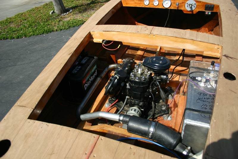

I'm Terry, the guy with the Kawasaki manual, and well along on a jet powered squirt.
My 1987 Kawa 550 puts out 36 HP, and its associated pump generates 350 lb of thrust. I don't have the specs for a 750, but just scaling up on displacement tells me it would be in the 55-60 HP range. Low end of the Ski King range, but certainly do-able.
Old Kawa's are 2-strokes. Nothing wrong with that, but be advised that many lakes no longer allow 2-stroke motors. If you go the jet-ski engine route, I'd look to find a newer 4-stroke variety - they put out on the order of 100 HP+, of course they will be more expensive. Inboards, unlike outboards, do not have a max HP rating set by the USCG. Thus you can legally go higher that the Glen-l recommended engine range.
Newer jet skis also have made provision for a reverse "gear" - actually a bucket that rotates down behind the jet nozzle, much like the arrangement is jet aircraft. Older models (like what is in my Jet Squirt) are direct drive. With the engine running you go forward, to stop you turn off the mill! When the engine is not running, you have no steering capability.
Here's a photo of the pump arrangement in my Squirt:
The pump is on a bracket on the transom. With the longer length of the Ski King this could probably be built into the boat itself. In the Kawa 550, the total drive length is 56 inches from the front of the engine to the jet nozzle. A 750 is a 3 cylinder engine (the 550 is a twin) so I'd add 6" or so in that case. Here's what the overall machinery layout looks like:
Hope this helps. Take a look at your plans, and see if you can come up with an approximate arrangment. Let me know what you come up with.

Nice work on the squirt! looks like you have a well thought out mechanical config.
I am not too familiar with the squirt design, but from a full size jet standpoint, the pump would need a shoe! Is it just not mounted yet?
