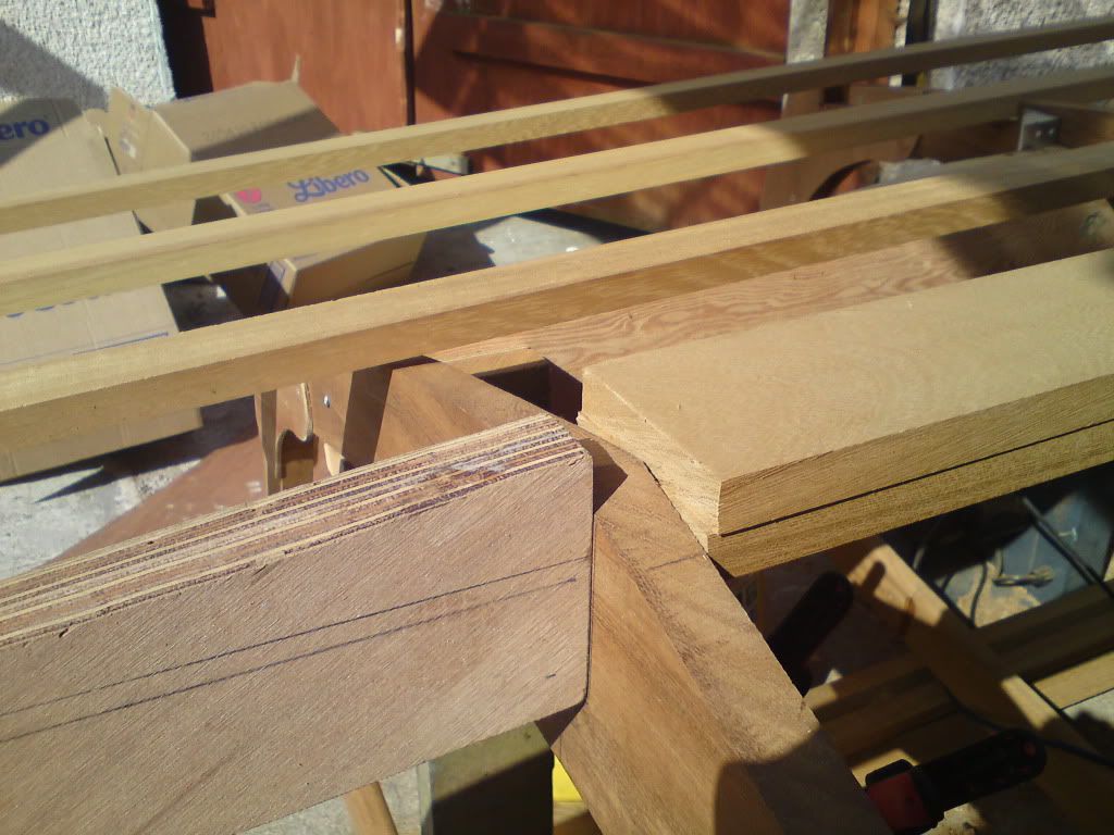

Am I missing something here frame 5 looks to be a bit low ,nothing is fixed yet but the way it's going I will have to take 1" off the keel,the stem looks like it will line up ok so should I bring frame 5 up to meet it. I think I got the 2"above floor level right what else could I be missing??or is it ok. THANKS.

Fergal,
I don't think you made any mistake. If you look at the plans the keel should be bent (bowed)
7/8" to meet frame 5. The keel is flat from the transom to frame 4 then it bows down towards
frame 5 and the stem. That slight bow matches the curve of the stem.
If you look at pic 15 in my photobucket album, you will see that I used 2 bar clamps to pull the
2nd layer of keel down to meet the first layer of keel and the stem.
