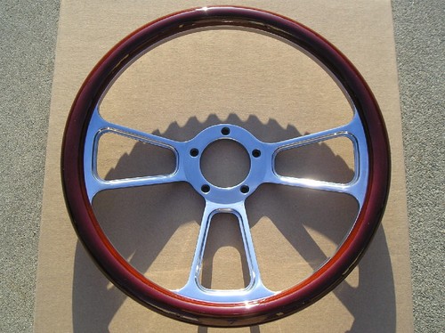

I wasn't too keen on the red and white steering wheel so I treated the boat to a mahogany half wrap aluminium one that I think will suit her, I didn't budget for this so I had to sell my seagull outboard to pay for it :D

Look's Great!!! I like the wheel!!

So beautiful, Fergal! Where did you get the wheel?

Gayle Brantuk wrote:So beautiful, Fergal! Where did you get the wheel?
Thanks Gayle :D The wheel is from forever sharp http://fssteeringwheels.com/ and it comes with a marine fitting push button horn and chrome shaft cover.
