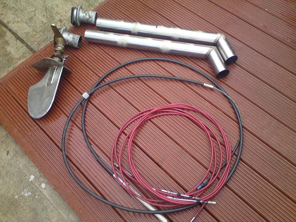

well I started to strip my donor boat today and the engine is ready to lift out and get a face lift, the rudder has a plate on it I hope it will be ok to use, I am still up in the air about using the gearbox in my standard cracker box has anyone done it and what are main downfalls, I am not going for a top end speed just looks and sound and a bit of fun.
I also picked up some planks of 4'' by 6mm

Thanks guys, now I am now entering uncharted waters with the planking and an inboard engine so it will be a lot slower from now on.
Your right Iggy the boat is in great shape I was in two minds what to do with it, now I hope to patch up the holes strengthen the transom and put an outboard on a jack plate then sell it on and get more boatbuilding money. :lol:

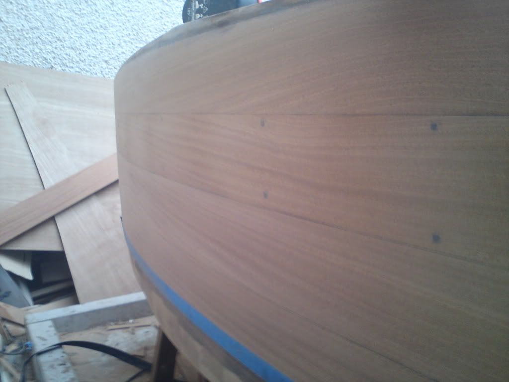

Just my luck when putting on the first plank my staple gun fired two shots and then gave up so I had to screw it on before it set, :( I filled the holes with resin mixed with sawdust from the planks. I coated the plank and the boat with resin first then I used a mix of west 405 filler and 423 graphite power to give me black lines,not to sure if I should of left bright now but only time will tell. I will be doing the chalking in black too.

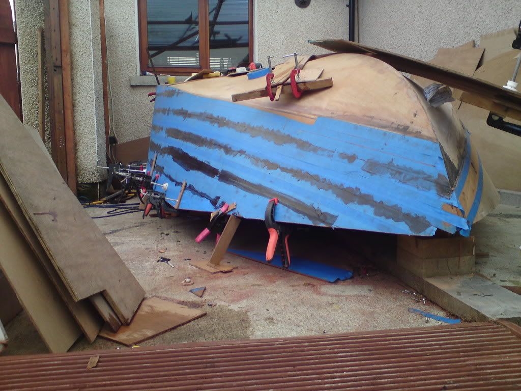

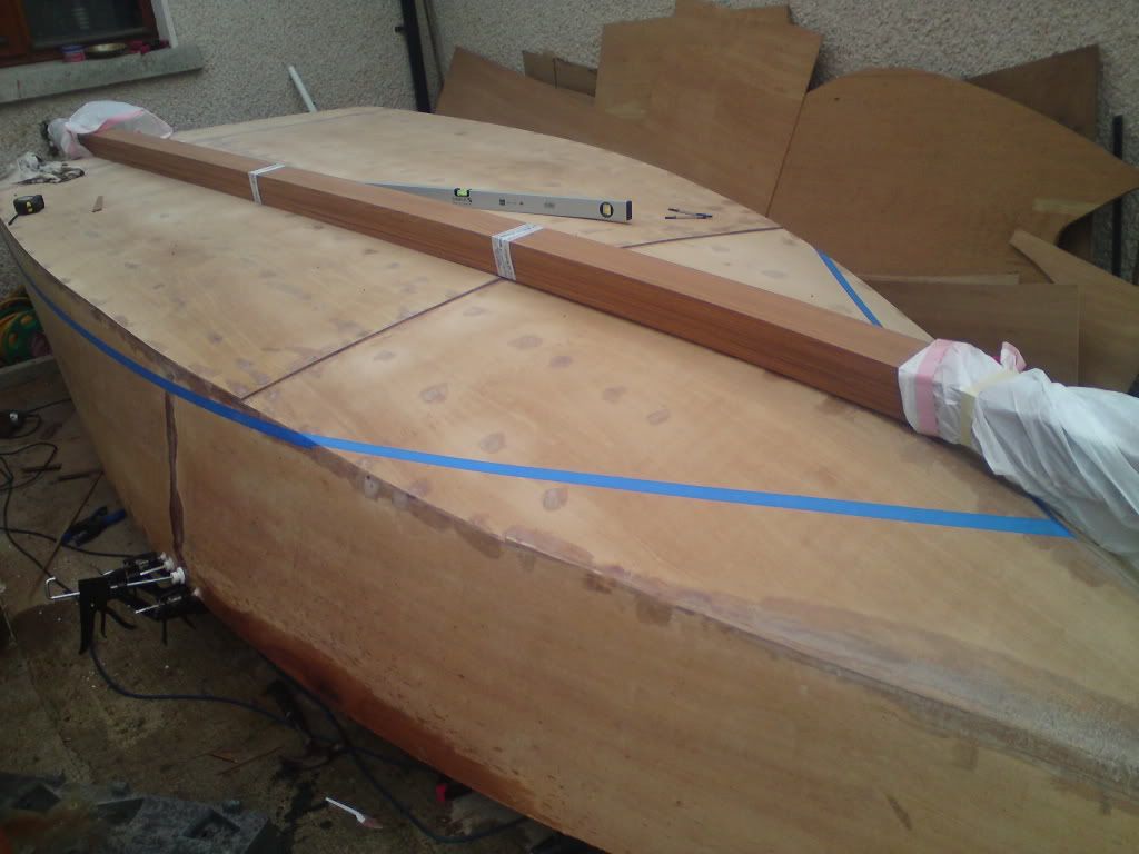

Just a quick question about the bottom planking over the ply. I have the sides done and want to bring the bow section up to meet the sides, do you do it the same way as the plywood going from a lap joint to a butt joint also would you run them lengthways or at an angle from the center line to get the best bright finish, I was thinking the step in the join from lap to butt might look a bit out of place,This is the way one side is working out. Any thoughts would be great thanks.

Ferg, are you using bottom paint?
If so, maybe have the transition joint far enough back to be covered with paint.
You can also just do a butt joint all the way to the stern if bright, it's just more work.

The transition joint will not be covered by the paint it is a bit close to the bow I was thinking of cutting along the top of the blue tape so it will follow the line of the boat as I don't want the step showing in the bright finish, will that work.
Also what would be the best way to bring the bottom planking to meet the side should I go length ways or come down at an angle, Thanks in advance.
