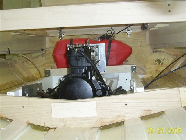

I am new to the forum. The past 5 years I been making wood rc boats. I have a set of TNT boat plans and have a Polaris SL750 jet ski for a motor. If any one has any good pics to help me out. That WOOD be cool. I have the frames and just making the jig now... Thanks Bill

:D THANKS YOU! Them will help.... I do not know if the jet and the motor will be too long to fit in the boat. Mite have to make it 12" 6" long.

The 750 is a good choice. My boat is about 12'6'' + the step plate on the back making it 13'. I modified the transom frame making it more V shaped and it works fine. I also added strakes to the hull. I also arched the deck making more leg room. Have no fear when modifying the plans to make things fit.

See the V shape of the Jet ski hull pc. you cut out? This is why I changed my transom frame and the next frames forward to match the V more closely.

Be sure and epoxy the heck under that grafted in part.

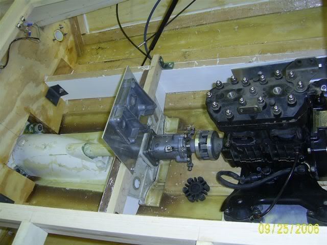

I notice the pump mounts land inside the transom, did you lengthen the hull?
To attach the platform on the back I added a 3/4'' pc. of ply across the transome and flush with the bottom. And then glued and screwed the platform to the top edge. And just used gussets to suport it.
I would bow the deck, it gives more leg room...
And I droped the center of my forms to make a more of a V hull to blend in with the jet-ski graft.

This is what i have so far. going to use bondo glass to build up around the jet drive. then do a LOT of sanding to make it look like it should go thair...
