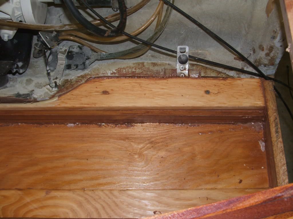

MLboat
Posts: 7
Joined: Sun Feb 10, 2013 2:56 pm
Re: Pump installation help
Post by MLboat » Sat Mar 09, 2013 7:27 pm
These blocks
BulldogBoater
Posts: 501
Location: Wilson, North Carolina
Post by BulldogBoater » Tue Mar 12, 2013 6:21 pm
Ahh...
I did put the screws back in. Now that I've done this a few times, I don't know that the screws are necessary. I have a tendency to overbuild and a little redundancy never hurt anyone.
KB
