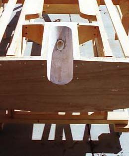

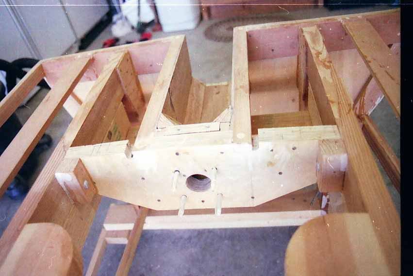

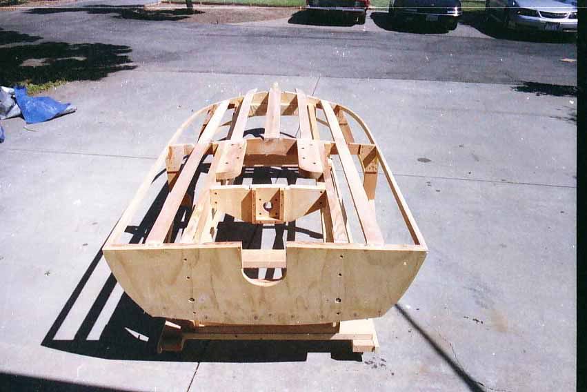

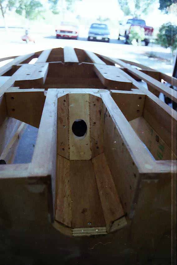

I built the jet inlet for my Jet Squirt. Most folks have just cut the inlet out of a donor jet ski, but for a number of reasons, I decided not to go that route. I also used a Kawa 550 pump (and engine).
I started with a rectangular plywood box, between the shaft housing bracket and the transom.
Then I "roughed in" the area, using 3/4 ply and some 2x2's split laterally at 45 degrees to get the top close to semi-circular.
The hole for the shaft is a piece of 1 1/4" PVC pipe potted in epoxy in both the bearing support and front of the inlet. After that it was just a matter of 4 or 5 "putty/shape/sand" iterations to get the shape just right. Here's a "semi-finished" pic

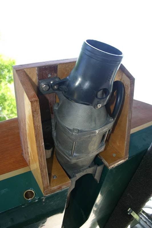

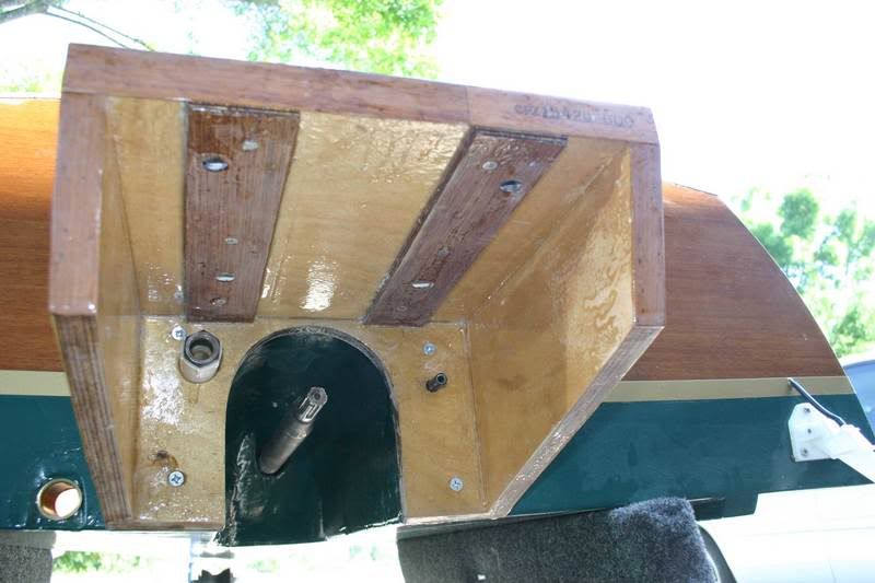

The pump itself is mounted to a bracket behind the transom (the Squirt is NOT a big boat!)
and finally here's the pump in place.
Hope this helps - any other questions, give me a yell.
TRM
