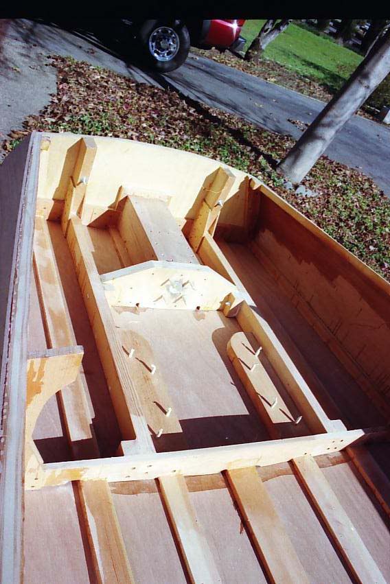

I didn't graft in any jet ski components into my hull, but just FYI here's what my structure in the engine bay looked like:
And here's the jet inlet.
I think you will have to have the jet behind the transom, but putting it under a "swim platform" is a good idea.
