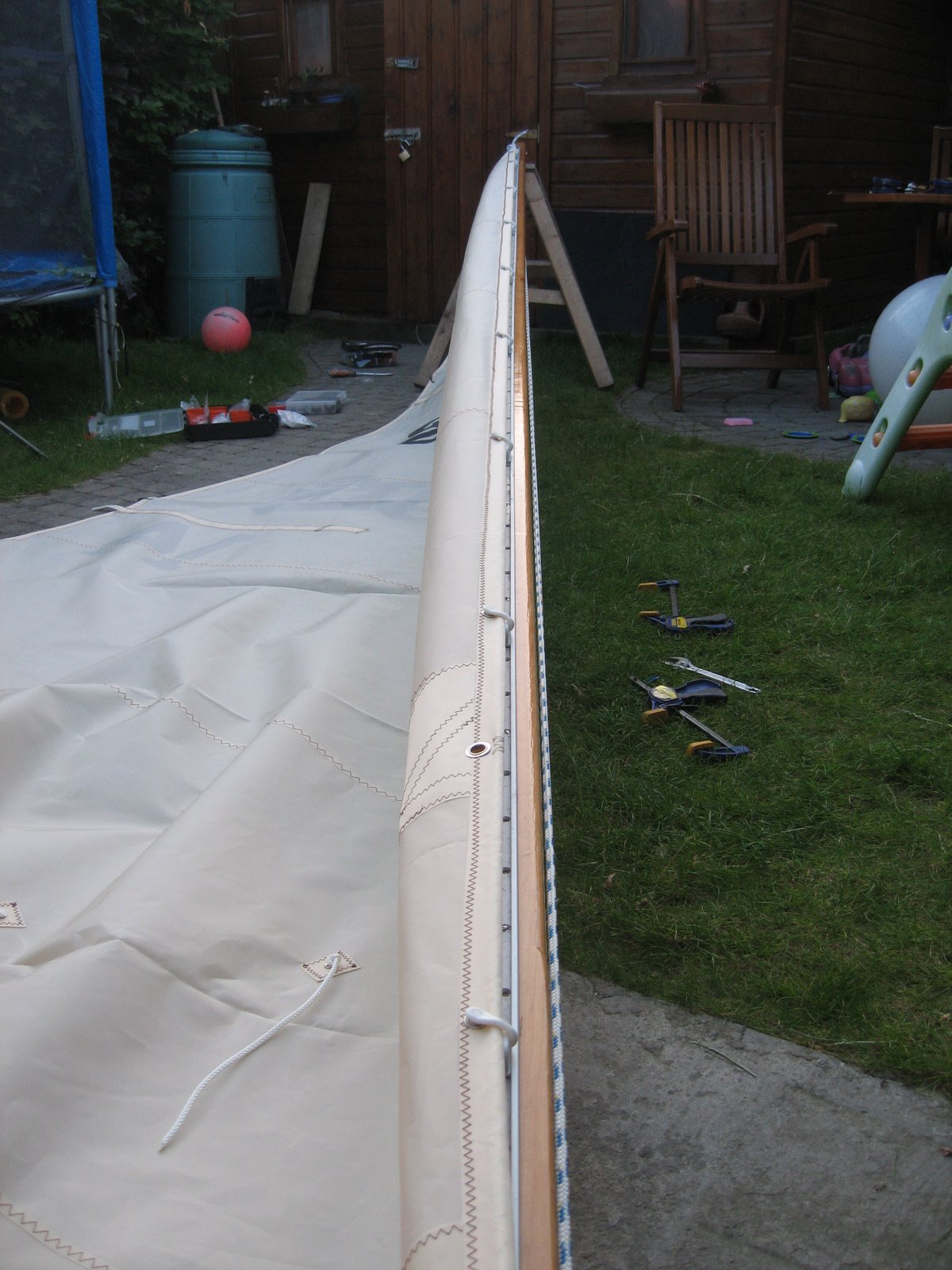

Just built mine from sitka spruce for a Glen L 14.
It's built to the plans, basically 2 pieces of wood, make a Channel down the middle & glue them together.
Be aware it is a LOT heavier than the equivalent Aluminium mast.
This has an impact on the ease to stepping the mast when you go sailing.
Be VERY careful to make sure you glue it up bang on straight. Mine has a slight curve :'-(
But only slight.
I did cheat a little & use Alu mast track. I spent too much time playing with test pieces for the bolt rope groove & decided that the risk of messing up the mast was too high compare to the simplicity of a mast track. (Brass would have been prettier)
