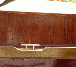

Lots of little fiddly bits. Stainless steel cleats, 1/4" 20tpi, through bolted at plywood butt joint plates overall thickness 7/8". This one is midships and you can see scarf when oak rub rail was joined.

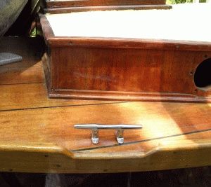

Same, another stainless cleat on the plywood deck panel butt joints near bow. Another set of cleats forward of these but larger and I am looking for 1/2" rope, skene bow chocks in stainless or bronze to finish.

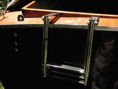

Swim ladder, had to block up so that it hung level. Through bolted and screwed. One of split back stay plate to the port side carriage bolts through transom
