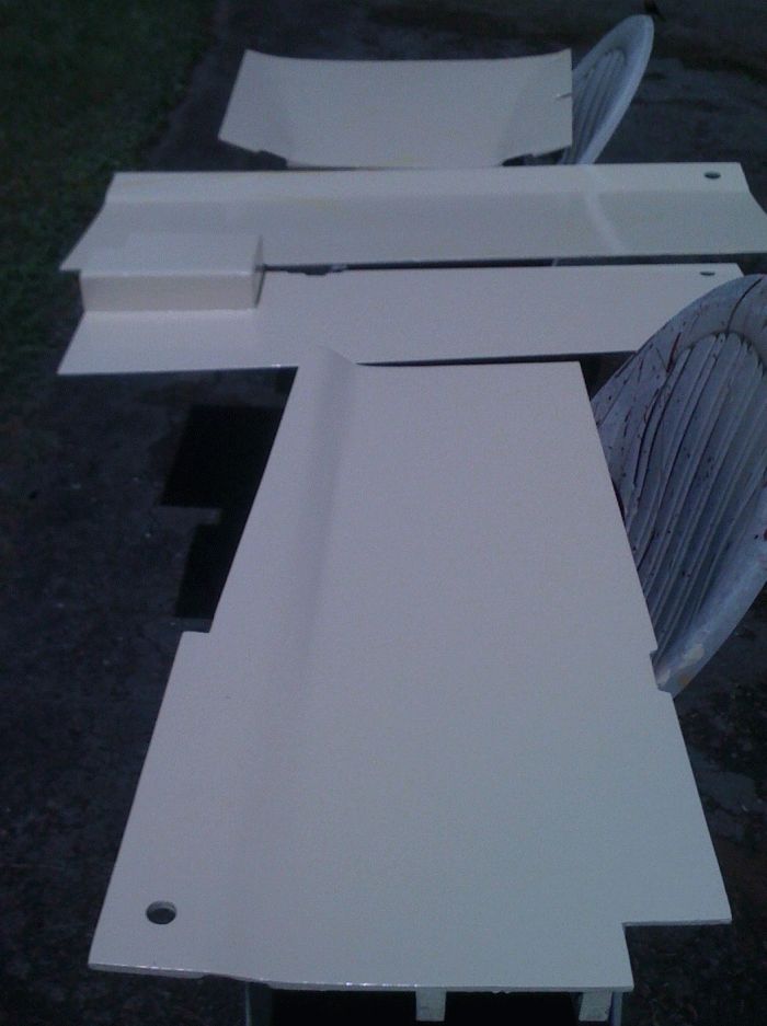

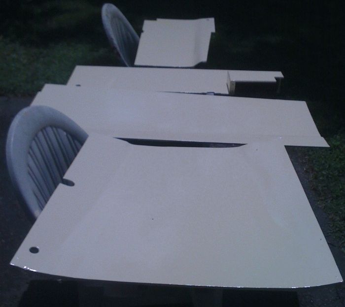

Finish the cabin sole parts. Four pcs. They are 1/4" marine ply with IPE battens. The floors lay on the hull battens and on backing blocks. Thumb holes for lifting out. Notice one floor has a box. This is for the bilge pump. Notches are for the bolts/washers going through centre board.

Look beautiful Stuart!
