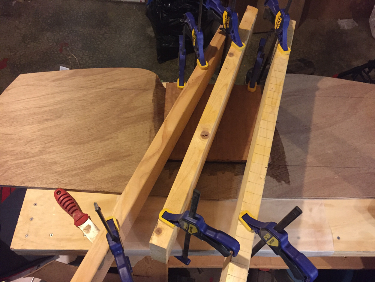

Here is a photo of my transom frame. I hope this helps.
The taper where the top pieces meet the motor board is indeed very thin.
-Michael

I did not attach the frame parts together separately from the transom, no.
I glued the frame parts directly to the transom, using thickened epoxy and a lot of clamps. So far, I have not used any screws on the transom.
I attached the pieces all together in multiple stages. First, I attached the motor board:
Then after the epoxy cured, I attached the floor beam and the sides:
Once the epoxy for those parts cured, I attached the top pieces. The key is to cleanly scrape epoxy away from the corners where the miscellaneous frame parts meet the transom. Otherwise, if you let a "bead" of epoxy solidify there, it creates a real headache trying to fit the next piece into place. I use a simple flexible putty knife to scrape away epoxy squeeze-out.
