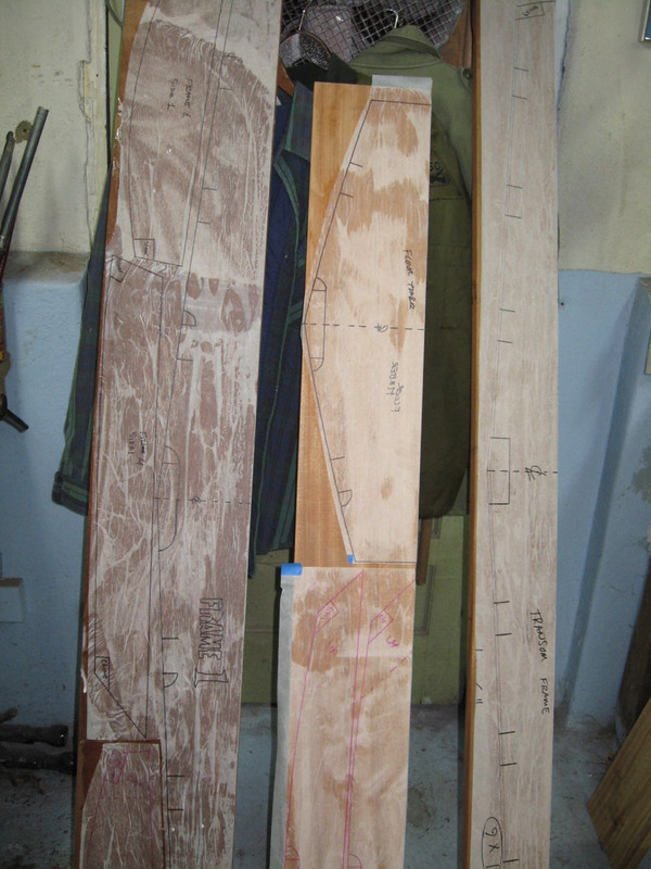

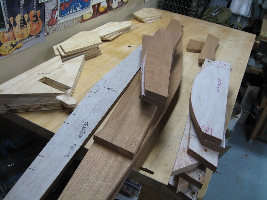

With larger pattern sheets, it does become a little more challenging. I have an 4x8 foot table I work off of that helps. I also take the patterns to a blueprint shop to copy and mirror the patterns so it is easier to make the full size pieces.. I also lay a thin sheet of MFD board on the table so I can draw the frames on it in full size to make sure they are correctly assembled. Reinforce any pin holes used to anchor the patterns to either the table or wood being cut. Make sure you establish the centerline accurately so when you flip half patterns, things line up properly. I use a pin to transfer the pattern to wood instead of transfer paper. Then pin holes are connected with pencil lines. The plans for the Torpedo came rolled. It surprises me that yours were folded.

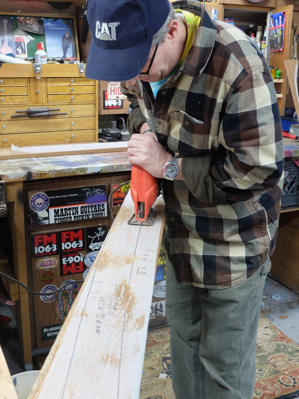

So I bought a roll of tracing paper, and laid it over my plans and traced the lines. I cut these tracings out "proud" of the lines, then mixed up Elmer's white glue & water to make a thin sloppy glue-water mix. I "painted" my wood with this glue, then glued my tracings directly to the wood...
Then it was an easy matter of sawing on the lines:
Easily done! Dimensionally correct! And the glued-on paper sands right off.
