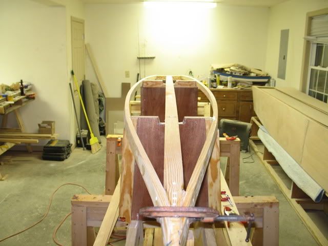

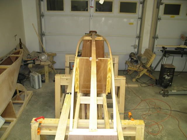

I wasn't going to update this soon, but I wanted to beat Oyster to the punch. Besides I don't think he came a knocking the other day for an update. I saw those fishing poles behind his back. :D The biggest change on the middle pontoon is it is 12' long while the other two are 16', thus it has one less bulkhead. Another thing I did different was to use true 1" lumber for the bulkhead framing and keel. Something I wish I had done all along. Also, the transom and station 1 are set an extra 2" aft so as to line up with the deck framing. Now remember my bow out problem with pontoon #1. I just knew it would be worse on this shorter pontoon, so I went back to my notes and realized I needed to really soften up the notch in the forward bulkhead. I think my one marble was sitting just right tonight. :D No fairing has been done, so be nice.

If you are referring to those brown bottles in the pictures I borrowed them from my neighbor. :wink: And if you examine the two pictures you will notice that there are three of them. They are placed in a perfect 90 degree triangle. The fore mentioned triangle was used to verifly the alignment of the laser that was used to determine the center of the keel. :lol:
