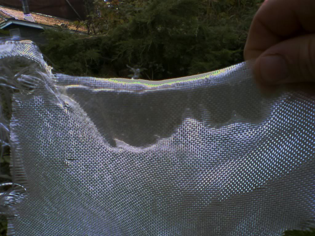

Just a thought guys...try some Interlux Epiglass HT9000 resin. It dries almost clear and it's great when you're trying to match tone (like in a repair). This is how it looks cured:
