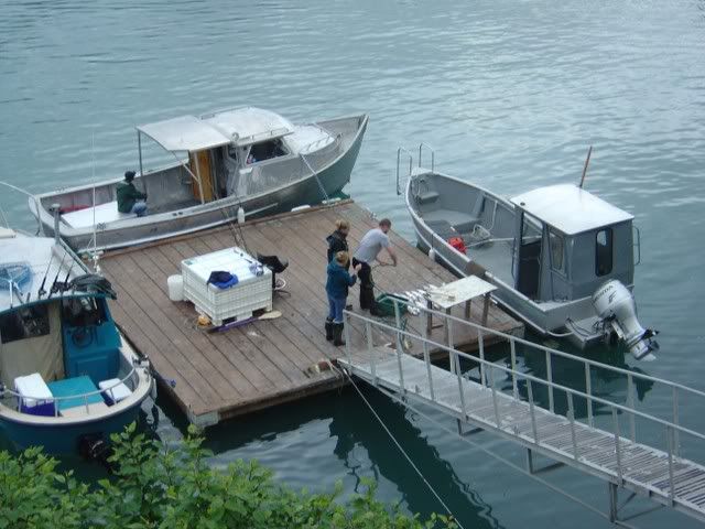

Re: aluminum framing choices for floating docs and gangway
North,
hopefully this image will post and do the 1000 words thing about explanation?
I looked for elements of docks in my photos but didn't find to many. This one does however have one that explains the inverted truss remarks. This gangway/is about 40' long and has a truss below it, the truss is made up of angles and they support the truss- combined with handrails.
We always use the handrail as the 'rail way' to move items up and down from the dock/float. A small cart with hollow wheels will roll on the top of the railings' top pipe like a track and then be pulled or lowered when something is moved too big to fit in the walkway.
This gangway is solid decked with welded aluminum on 3" (I think) channels - but it was a series of four or so pieces the owner salvaged and we put together into one piece- scabbed together might be a better description?
hope this helps.
I don't very often do designs online, reason being I have not view, control or influence over the resulting builds - but I'd be first inline to catch it if for reasons way beyond my control- something went amiss?
Sorry my remarks weren't any more clear. If I remember out barrels under this float, we have to strap them in using 1x1/8" bolted to the frame (wood) in order to keep them implace. We also filled them about 1/4" full to make the top of the float lower to the water if I recall? While some framing can keep the barrels in place, we always strapped them in before the deck went on.
I designed and built the two boats on the left and a student/trainee/past employee did the skiff on the right of the float.
Not sure of why a 6' wide gangway is needed? At the lower center is one of the cables fixed to a steel stake on the beach and attached to the float so it can't drift side to side.
hope this helps.
